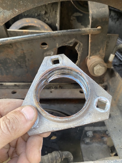

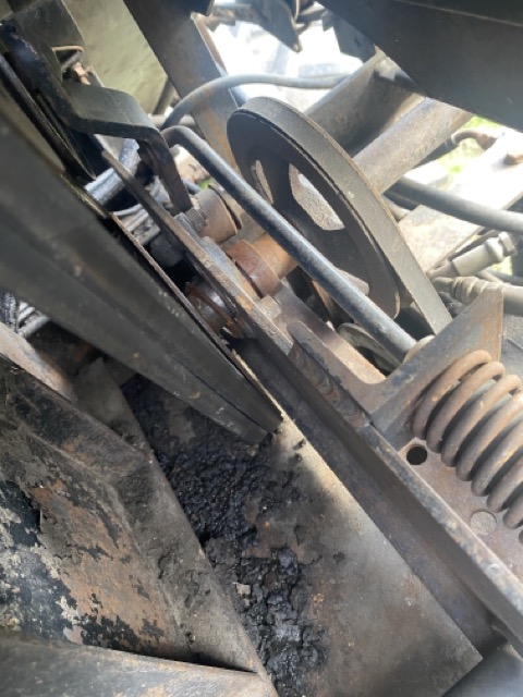

Inner bearing on front pto left go, that is driven from engine below the fan. It sure looks like I need to unthread the pulley in the limited space up there to get the shaft out.
Any tips or tricks?

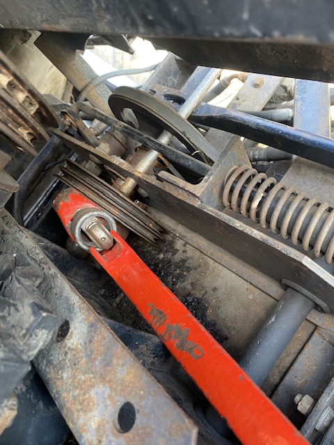

Was able to remove the nut, still working on the pulley.

Jam a bar thru the pulley spokes and a big pipe wrench on the shaft. Make sure you go the correct way.

I wrapped a chain around the pulley that drives the pump and used a come-a-long  anchored to the rear axle. Make sure you are turning it the right way. Pipe wrench didn't work for me.

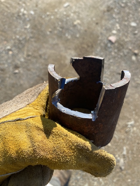

I ended up making a 3 finger socket to turn the pulley. Big pipe wrench on that worked well. Just tedious. Unfortunately being Sunday, the only bearing I had on the shelf was a greasable one with setscrew lock so I’ll be back into it before long.
