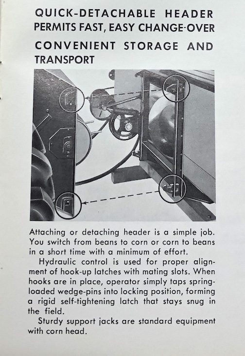

Anyway early 1968 gleaner F / EIII may have had the older 4 "slot" cast hook header attachment design like shown below?

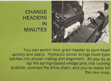

I believe the 1969 F / G /K & up serial #s had this newer 2 top hook onto pipe design like shown below. Since your forum name is 73gleanerF, I'll assume your are referring to this design?  Not to say that sometime/someone may have replaced its throat with an older 4 cast hook design shown above?  Can't see its lower slot cast hooks in this photo. But they are the same design as the earlier 4 cast hooks.
