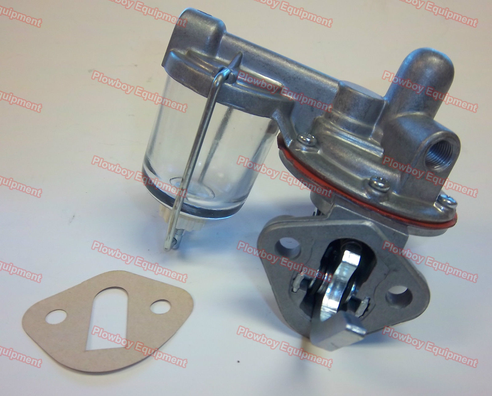

Did some looking around on eBay...this looks like it even though it's not listed for it.   Priming handle is different than original but mounting boss looks right and fuel bowl sticks off to the right correctly.   $22.09!   Might have to pick one up myself for another spare.  Good thing is new ones should have diaphragms that work with E10 fuel.   Mike
