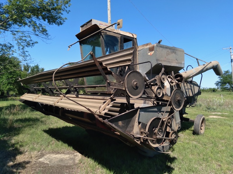

First, thanks to the forum for putting up with my random Gleaner questions over the last year or two. AC7060IL - special thanks to you and your knowledge of Gleaners in general.
I lucked into a CII that is only about 10 miles from my house. 16' header with no special equipment (just straight bats) and some rust/rock holes in the bottom/floor that I will have to tackle. It has been inside and was supposedly last used 5 years ago. Other than the fans being packed with rat nest, everything seems to move. I did get it to run for 15-20 seconds but only with the choke on, so I pulled the carb off and am cleaning it up. It was converted to a Carter electric fuel pump at some point but after repairing rat-chewed wires and getting good 12V to it, turns out that pump is toast.
The cooling system took about 1.5 gallons and later on I discovered a pinhole leak in the radiator just below the top hose connection. The gearbox for the steering shaft at the bottom of the cab seems to be empty. Otherwise the tires all took air and you can steer it with no engine power fairly well. Trans and finals were all full up to the check plugs. I changed engine and air cleaner oil. Still need to hit all of the grease zerks, reinstall the carb, and wait for the new fuel pump to show up.
Anything specific on these that I should for sure check before I try to road it 10 miles home? I have done nothing as far as the separating mechanism is concerned - I don't plan on touching that until I have time to clean it out and change some sprockets, chains, and belts. I'll leave it shut off for now.

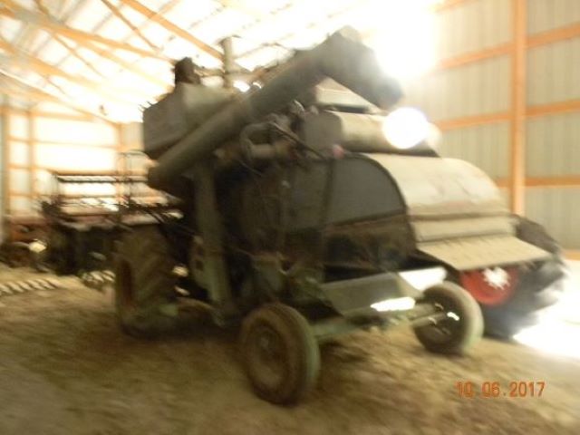

I still have one in the barn quit using it when I bought the L3. They are a good combine and you have been given some good advice. As the Dr says check the variable speed and engine belts. I had the variable speed belt come apart on the road and it is not a good feeling when you coast to the side of the road.

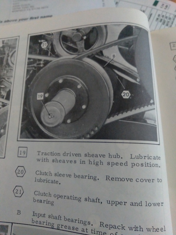

I checked over the main drive belt from the engine and the traction/trans belts. There is no obvious damage or cracking so I will hope I can make it up the couple of hills I have to climb without any issues. The only play I could find at the rear wheels was a little bit in the spindles (not hub bearings), plus some play in the tie rod ends of the steering linkages. It's detectable but not scary so I am okay with it. May need to be fixed some years down the road.
I hit as many of the grease zerks for the steering/brakes/engine/trans drive as I could yesterday. The pedal shaft zerks under the cab sure are a bear to access. Filling the steering gearbox also wasn't great but it's full for now. I was unable to find one zerk, though. I think the I got the #20 clutch sleeve bearing assuming that's the one that's on the cast housing going from the pulley on into the transmission, and I know I got #19 on the end of the sheave hub. I don't think I found the #21 clutch operating shaft fitting so I need to maybe crawl under there with a flashlight. That might be on the linkage from the clutch pedal, closer to the clutch?

It made the drive home today. The radiator leaked slowly enough and the temp gauge works so I was comfortable with the cooling situation and it worked out. I couldn't get the variable speed lever for the ground drive to move and the guy who was in a truck in front of me said I was only doing about 6 MPH, in 3rd gear, so it must be stuck in the slow position. Sure felt a lot faster than that as I was bouncing down the road.
The power steering started working after about 1/2 mile which was nice. I think one of the brakes may be dragging a little as there was some slight lurching and rhythmic whining. It seemed to go away on downhills, though.

wJohn, congratulations on a successful drive home. Machine looks great. Thanks for sharing a photo of it.
