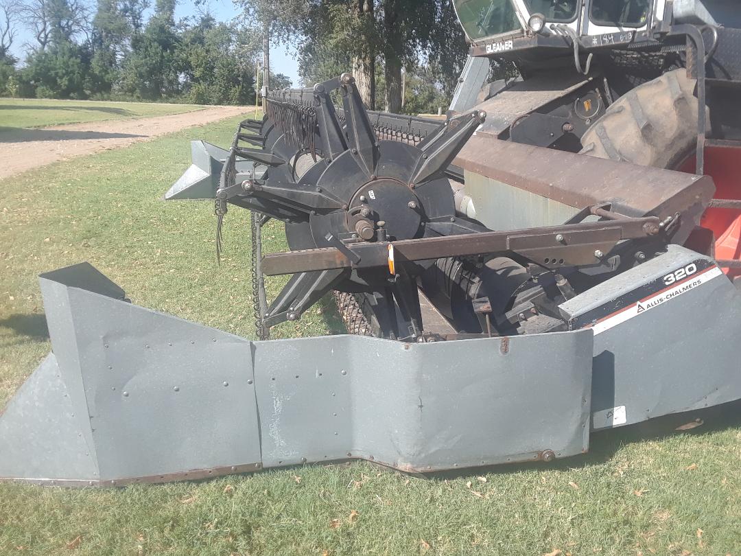

Picked this 320 up a couple weeks ago, does anybody have any quick tips or tricks I need to know before bean harvest here in about 3 weeks? We got some good rains this year so I will be dealing nice tall beans. Thanks for any quick advice.

Thanks for the info guys, another thing, I noticed you didnt have the outer row guides or whatever they are called on your header in your videos, is there a certain time a guy should or shouldnt use them? i would rather just take them off, Thanks

The outer gathering dividers were there and they are the long dividers like yours, not the short. I should have done better with taking the video. I thought maybe the shorter dividers might do better but never had any to try out. I do have pics somewhere of the flexible drain tile mounted behind the cut bar that I could post. It's just that 3" pipe like they use when they tile out a field, very flexible and the outside diameter is actually about 3.5".

These dividers have a bunch of adjustment, it looks like I could shorten them up about a foot before they got in the way of the reel. Maybe I will go that way. Is there a need for them to be so far out in front of the reel that I am not seeing? If you find the pics of the drain tile mounted I would like to see it if you get a chance. Thanks for everything.
