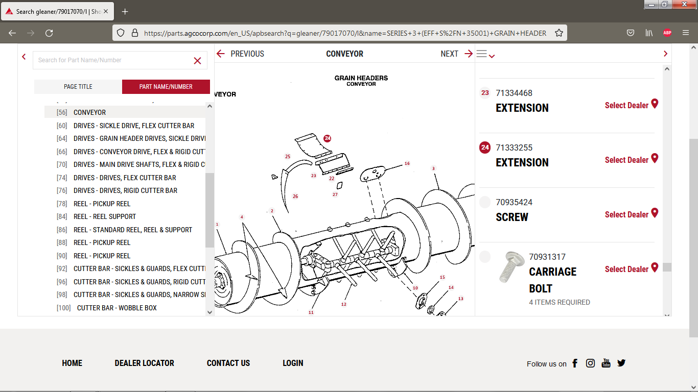

Bought a 20ft 300 series head last fall for my new to me R52 in the middle of bean harvest. Head was working alright but i was constantly fighting issues plugging the feeder house and getting green stemmed beans wrapped around the right side of the drum. Quickly figured out this head was set for a R62/72 and not a 52 like i was told,  Fast forward 7 months and i finally remembered i never did fix the header issue for wheat. Called a local Gleaner dealer today and of course the young parts guy doesn't know what i'm talking about. The only manual i have for the head appears to be for an L or M and is no help. Agco parts book just lists everything as extensions and doesn't say whats needed.
So can anybody help me out here? Mainly need to know how many fingers i need to remove, and what flighting/fairing extensions i need if or if i need them at all.

items 22 thru 26 plus covers where you will pull out all fingers that are trying to stuff crop into a place where there is no opening.   Close the throat with 24 and the other is flighting extension and floor extensions.  It is a little more specific on the 500 series parts diagram.
