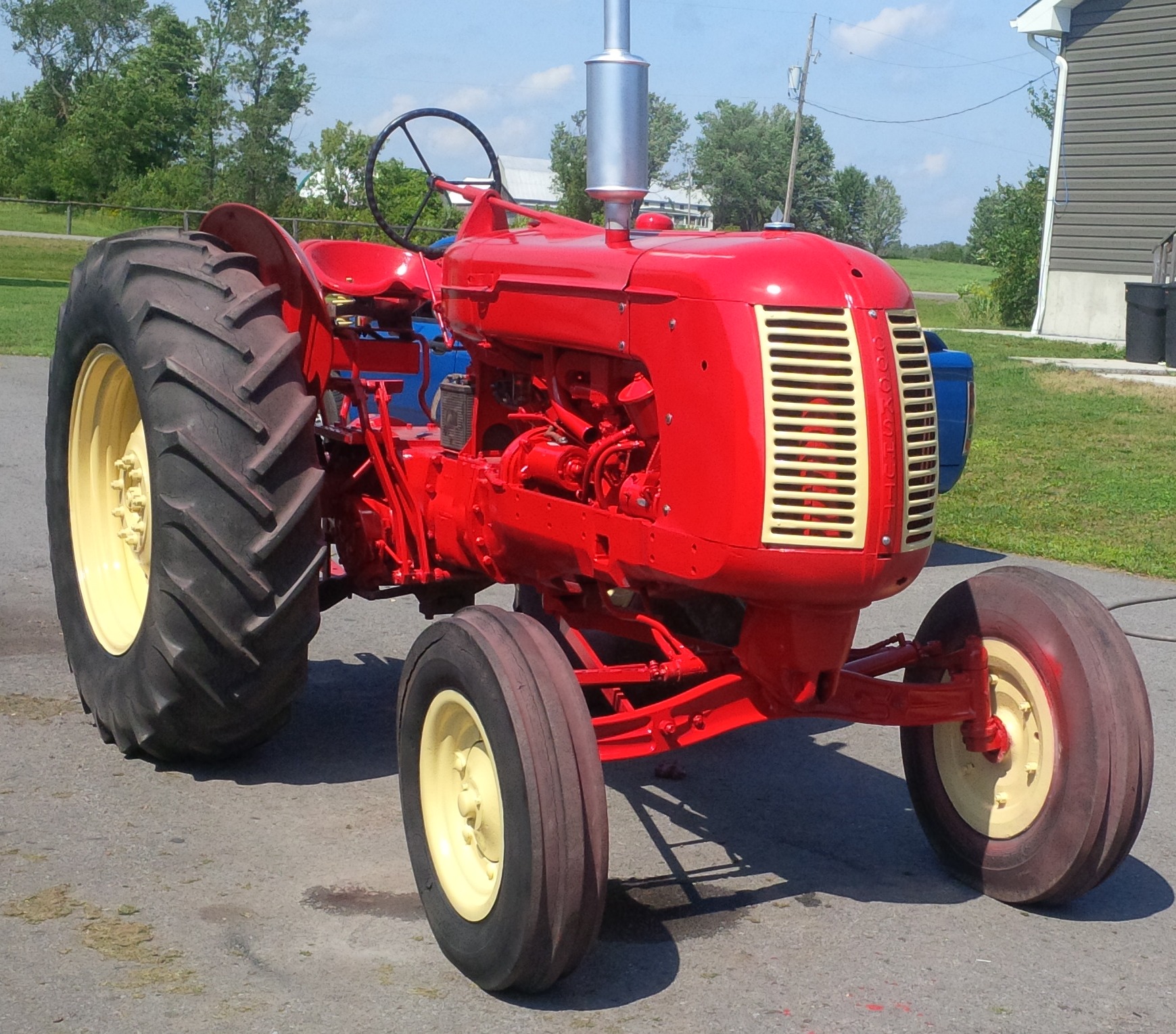

    Posted: 27 Sep 2015 at 6:39pm
The whole project came together well until today. I was driving it home from the plowing match which was about 5 miles away. The oil pressure is about 15 psi lower than it was a week ago. at idle, about 5psi and 10 to 15 revved up a bit. I am wondering if there is a leak in the motor in that tube that routes the oil though the full flow filter, relive valve stuck open, or such. It still runs nice an smooth as it did before. Anyone ever had this happen? I think there is a relief valve on the side of the engine like the old B series and on the oil pump also IIRC. Appreciate any thoughts.
