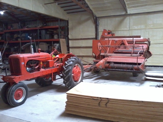

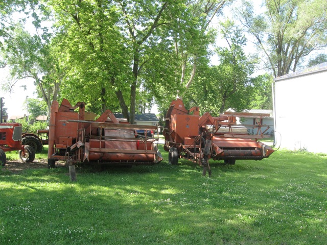

The combines are outside. Tomorrow I'll hook up the 72 and bring it into the shop and see what it will take to replace the concave bottom with the patch sheet I got from Yaz All Crop. I'll see if I can get the bad tire on the 90 replaced, then Sunday I'll hook up the 90 and see if everything turns and try running it with the tractor if it does.
I don't think I'm going to get a wheat screen for the 90 before the wheat is ready so IF everything works on it we'll try it without one, otherwise we'll try it in soybeans this fall because we have a finish screen for those.

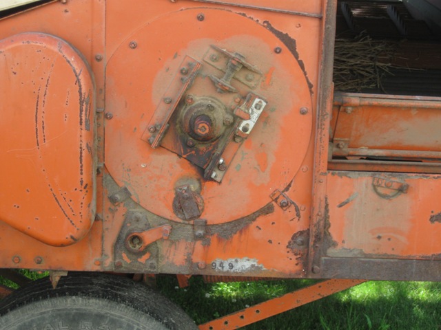

The 72 is serial # 949 (A Sharpee does a nice job of highlighting the numbers) I think it's a 1960.

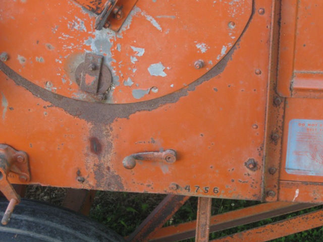

The 90 is serial # 4756 I'm not sure what year it is. I'll post more pictures as I go.

   Your 90 is a 1959. Your correct on the 72 year.

The combine got the honor of being the first project in the nearly complete new shop.

Can anyone tell me, does the drive shieve have to come off the cylinder? It looks like it might all slide out in one piece but that seems like it would be too easy.
It looks like this will have to come off to get to the concave after the cylinder is off.

What reference source do you have?

   Norm Swinford's Farm Equipment book.

We did five 72 rebuilds in our shop this winter. You will have to pull the cyl out the end where you show the picture of the end cover. take off the top shield you show in the next pic. We always pull the head off and the beater out of way so we can work. Rebuild everything as you can get to everything. We make our own concaves and many of the parts that we use. If you want you can PM me and i will give you my number and you can call me. I would be glad to answer any questions.

Curt, thanks you might be getting a call. So if we take the shieve adjusting arm off will the cylider come out with the shieve on the shaft? It will probably be the weekend before we get back to it.
