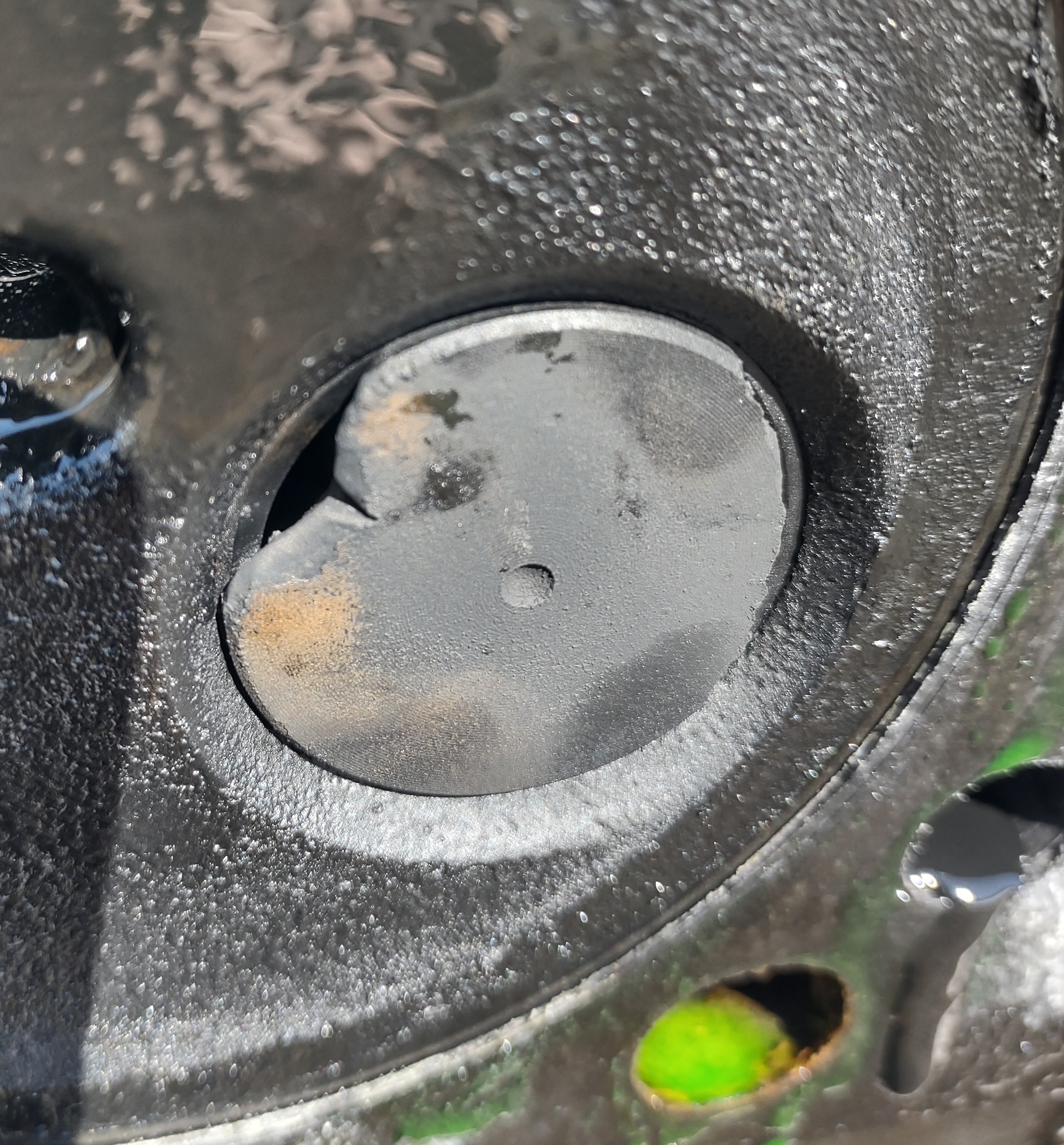

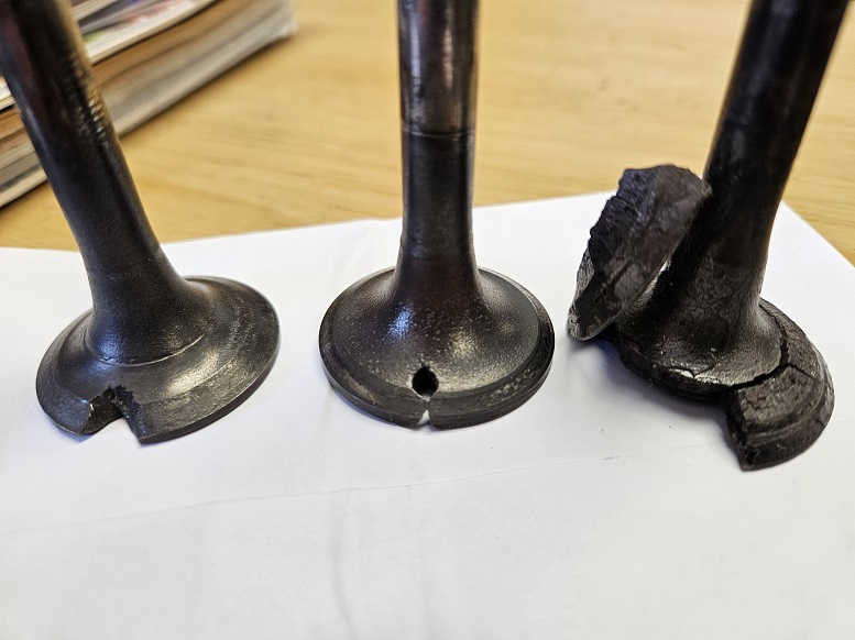

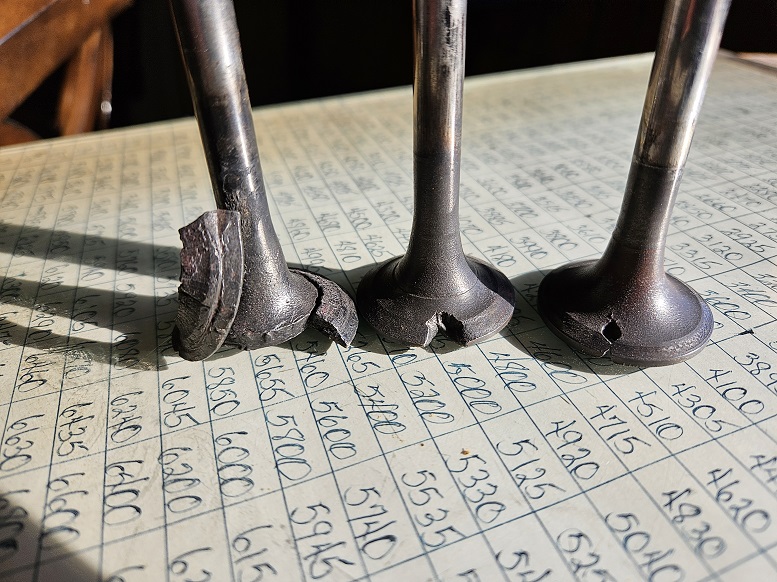

Decided to tear into things today, as the sun was out and we had a heat wave of 36 today after a high of 20 and snow yesterday. I did not do a leak down test for a couple of reasons. #1 the cylinder that is the main issue at the moment has 0 compression. If it's not a head/valve problem, I'm going into the bottom end, so may as well do an O/H at that point. If it is a valve problem, I'm going to have to fix the head first anyhow, and then put it back together and see if it solves the issue. If not, it's an O/H at that point as well. #2 I don't have a leak down test setup yet.
Did get the head off. #4 exhaust valve has 2 edges off of it. 2 other cylinders (two that were lower on compression as well, had valves that are looking a little rough.

That will do it! lmao!

I'm surprised the top of the piston, head and sleeve aren't damaged. Apparently, the pieces went out the exhaust.

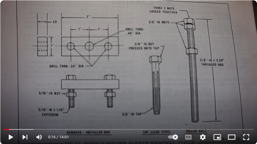

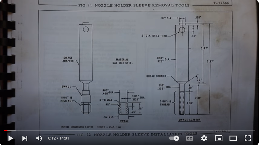

If the head isn't cracked, it would get new copper sleeves for the injectors if it was mine.

I've been watching this thread to see if anyone was going to mention the copper sleeves. Not every machine shop will be have the tools and know how for this repair, correct?

Allis dealers (not all) had the tooling. Not most machine shops.

Just curious What would cause damage like that detonation or something going thru the engine? Timing off causing it to run hot. I suppose a person can get all the head stuff in order and put it back together with a good pump and injectors, but I would wonder what caused it.

I'm curious myself.  A little background on this tractor.  Bought it 3 years ago.  Has always ran pretty good, but hard to start.  Gave $5k for it with a set of duals and another set of 16.1 4 rib front tires.  Used it for tillage, mowing hay, baling, picking corn, you name it.  Would lug down and black smoke on a hard pull, but never let me down.  Has always had a pop in the exhaust, and a fuel haze.  I figured injectors on the haze, and straight pipe on the noise.  Put close to 200 hours on it last year, and used 2 gallons of oil.  I don't consider that bad for a 1978 model tractor that is showing close to 4000 hours.  Couldn't get it started last spring, and no fuel to the injectors.  Had the pump sent out to injPumpEd and he did an excellent job on it.  Found out that pump was off of a combine, and not set up correctly for the tractor.  Got that part fixed.  Planned on doing a set of injectors this year.  Started really thinking about things last summer and fall, and tried figuring out what could be the issue.  Really thought it was a valve or head issue, just from the noise and the way it ran.  Compression test verified that.

This is another of those kind of rare problems. Gas exhaust valves were more frequently replaced because of burning. The diesels, not so much, but it does happen. That particular valve hasn't been doing its job for some time. Hard starting and low power go with that sort of damage. A trained ear can hear that wheezing, when the engine is turning over, quite easily. Your popping noise is the compression going right out the exhaust. When an intake valve does something similar, it pops back through the air cleaner.

Good call on where to start, I started a wall of mayhem in my shop several years ago of odd carnage that happens throughout farm life such as a broken fan shaft on a blue tractor that sent the fan into the radiator or severely worn elevator chain sprockets, odds and ends that later you look at them and say yep I did that. Those valves are prime examples of inductees. I write the cost of repair and the date, it serves as a reminder to stay safe and on top of maintenance. Good luck with your project, I always say it's better to fix these things now rather than when the machine is needed

I would guess that it started as a tight or warped valve which started leaking combustion gasses which quickly leads to cutting torch effect. Burned it away not a chunk broke out.

Not sure how it plays out on a 7020, but I replaced the head on my 7000 with one from a 190xt/200 (no copper sleeves) and had Ed put new tips on my injectors to match.  Again, 7020 has a different thermostat housing and potentially different injectors, so may not be possible, or advisable due to the higher hp output (more heat).  But maybe someone with more expertise could comment.
I had cracks forming around the copper sleeves to the valve seats on my head, so it was no good.  Get the machine shop to check around the injector holes for cracks if you do keep that head.  Where it's machined out for the copper sleeve to be swaged there, the injector hole is bigger so less material between it and the valves.

Found a video on youtube showing how to make the swage if you have trouble finding someone with one.  Doesn't look too bad for someone with some decent lathe skills.  Here's a link and the screen shot of the swage and the puller:
