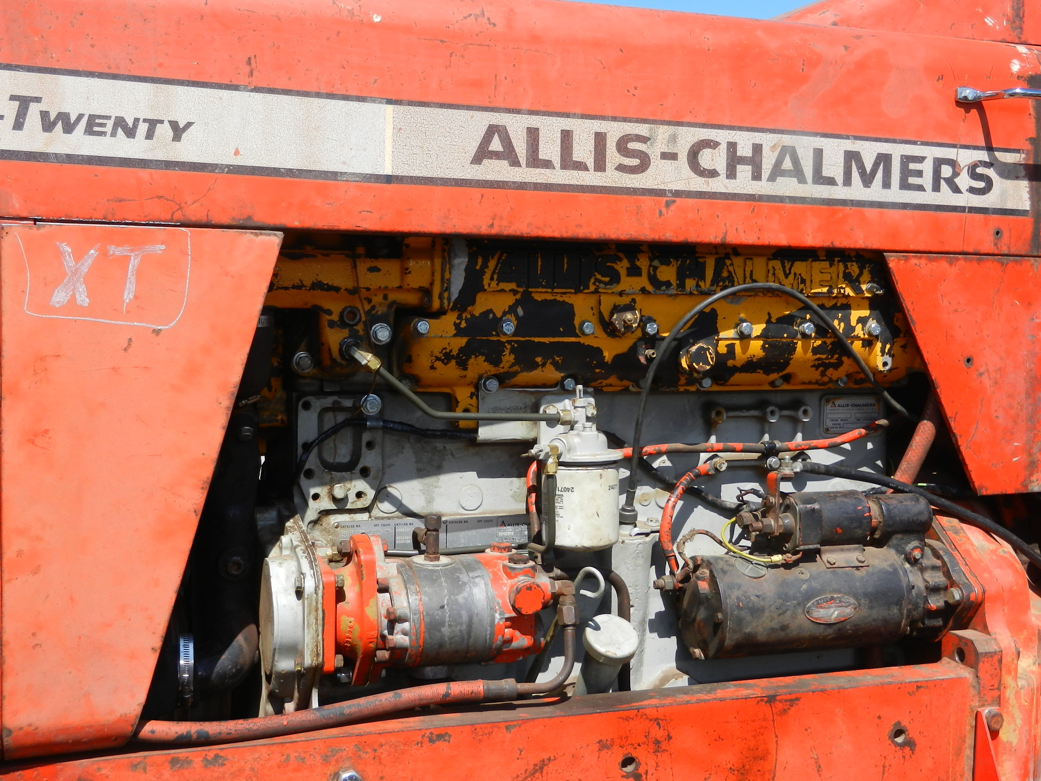

So I'm putting an inner cooler off a 7060
on a 220 and it has some sort of an probe for lack of
knowing what it's actual name is but I think it is the ether
injector maybe,any help would greatly appreciated.
This one is broke off.

Ether atomizer. It's brass. Carefully drill it out I guess. How are you going to connect up the coolant flow on a 220 water pump?? or is this a newer Mark II engine from a 7000 series??

Yes,likely the ether injector. You could leave it, block it, or drill it out. It's made of brass so it would drill easily but getting the chips and pieces out of the manifold could be a chore unless you have the inner cooler disassembled.

I haven't got to that bridge yet Dr Allis.
Yes I have the cooler out of the manifold.
