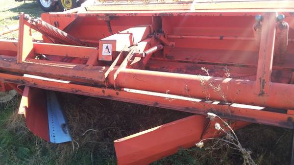

Hi all,
I'm new here and trying to build up a fleet of haying equipment for a small acreage. I have an old wire tie AC303 baler and am looking at this pull type swather. I have many questions:
1) Does anyone know what model this is?
2) What is the minimum horsepower you think would be needed? I have a Kubota LT4200 right now.
3) Is there anything in particular that I should be looking at on this machine? I'm new to swathers.
4) Any suggestions on how to transport it about 200-miles?
5) Based on the pictures, how does the condition look?
Thanks in advance for all the information and advice. I really appreciate it.

Welcome to the forum!  I'm sure you will enjoy your visits here, more knowledge available then you can shake a stick at.
There is a machine like this on the Denver craigslist for $900.  Don't know if that is a good price or not.
I think a 45HP Kubota will be adequate, but just barely.

I run a JD 1219 swather. It's a 9ft cut and according to JD requires 35 pto hp to run. When I bought mine I loaded it sideways on a 16 ft trailer and took the tongue off. We went about 60 miles or so this way. If you load one this way make sure the tongue and gear box is on the front end of the trailer! If you put it to the back end, the tail will wag the dog the whole way home.

Looks like a mod.904 or could be a 829 It looks to be in pretty good shape for it's age. However the AC mower/conditioner was not all that great of a machine. Sickle drive was known to give problems and they had a wider transport width than alot of other brands. I would look for a 7' cut New Holland for a small acreage.

I had a NH 477 (7') awhile back and had pulled it easily with a CA. If you don't mind working on something that is hard to find parts for the AC unit may be a good deal. I consider what is the best local dealer in your area and go from there.

The condition looks pretty decent. Paint wear is normal out here, and our New Holland looks worse for wear than that. If the seller has a tractor, have them run it for you.

That's an 829. I have one out in the fence row that we just plum wore out. No wobble box. Has a pitman arm sickle drive. Keep the sickle in good shape otherwise belt would slip easily. When our rollers were wearing out they wouldn't pull fine grass through. Alfalfa was no problem. It looks pretty good in the pictures. Guards and sections may be tough to find. Bearings could be gotten at any bearing place. Main drive belt and sickle drive belt are pretty specific to this machine. Might be able to cross reference. Good Luck.
Steve

I just thought I would check back in and update this thread in case anyone searches it in the future.  This is an 829.  It works pretty good.  Not awesome, but a lot of that could be "dialing in" that I need to do on the machine.
Also, my Kubota L4200 has not problem pulling it.
