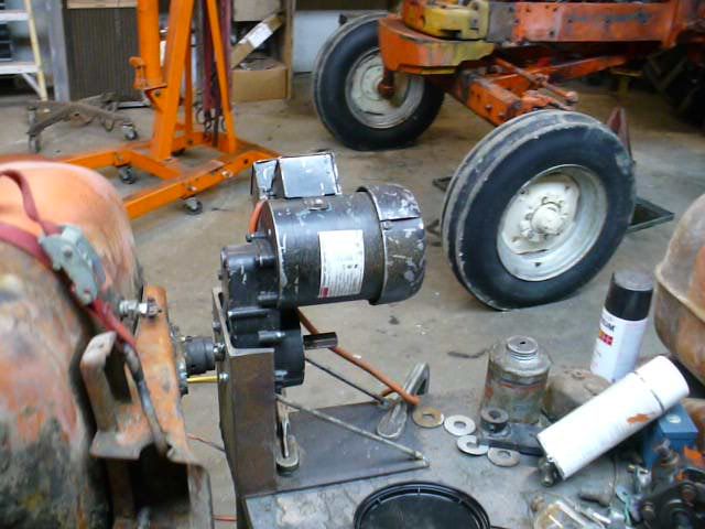

Here's how I used to clean them, I have built a tank cleaner that rotates at 1 rpm.
Edited by Don(MO) - 20 Sep 2017 at 6:25am

Post Options Post Options   Thanks (0) Thanks(0)   Quote NEB-KC Quote  Post ReplyReply Direct Link To This Post Posted: 20 Sep 2017 at 9:48am
Thanks for the suggestion. I would never have thought of that method.
