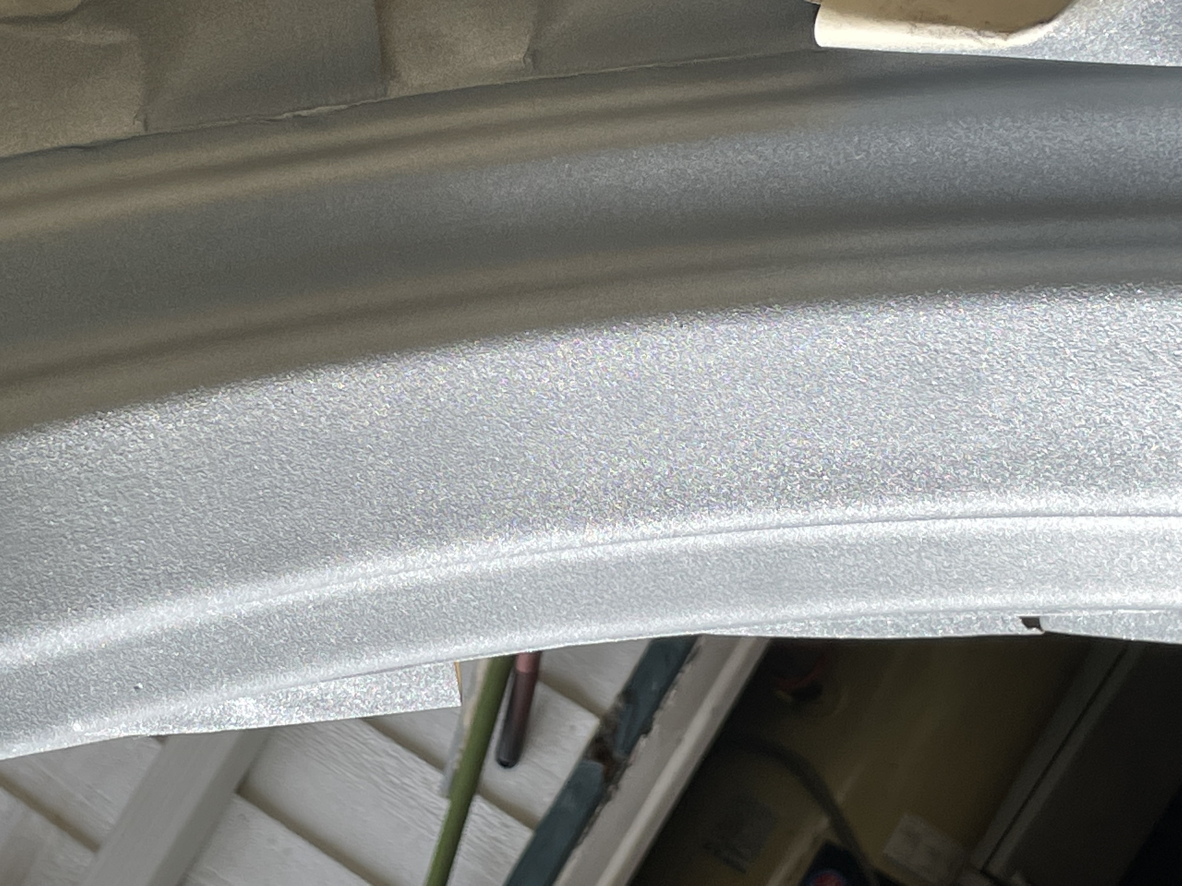

My ib rims are in good shape, except the galvanized coating is pocked/chipped. Painting the rims silver shows the unsmooth surface. What works well to make them look better/smoother surface - the remaining galvanized surface is tough to sand off.

If your going to clean and paint the entire rim... i have had pretty good luck with this..

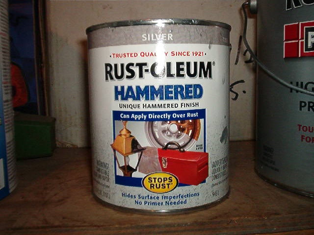

I've had great luck with this -

what I used on the guards on the new idea 30 sickle bar mower . Looks good to me , good choice.
