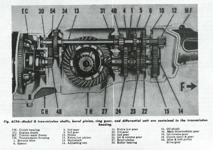

got a picture of the G tranny? might be a way to adapt it.
Points: 88237
Post Options Post Options   Thanks (0) Thanks(0)   Quote steve(ill) Quote  Post ReplyReply Direct Link To This Post Posted: 04 Jan 2022 at 8:35am
the transmission on the G is installed backward... the PTO housing is removed ( as on a B) and the trans back end is bolted to the motor clutch of the G... The "normal" front end of the B transmission is now at the far end from the G motor... and a new LOW GEAR case is installed between the trans and the main frame of the G...
