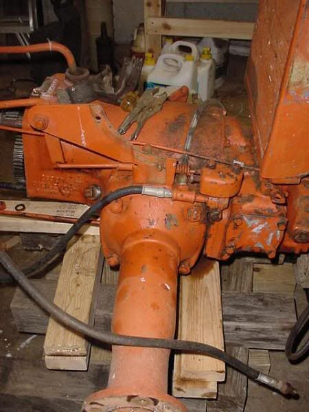

I have a 1951 G with front and rear hydraulics, but embarrisingly enough, I don't know how to put fluid in or where.  The rear hydraulics connections for the rear furroughing bar are leaking, so I need to address that and put in fresh fluid.  I have the little manual, but it doesn't say where to put fresh fluid

Large plug in left side of housing right behind clutch pedal pivot "oil level" cast into case next to it
you can see it right above the black hose in this shot
here's a better shot, plug isn't in the hole in this shot
