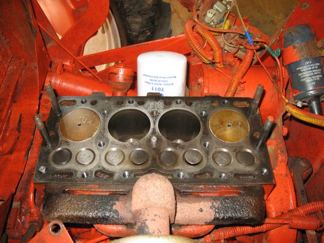

Found the source of my G's leaking head gasket - two broken head bolts.  Lower Left and Center.   Center stud sticking up 1/2", the other is approx 3/8".
Help:  Please tell me the recommended method of removal.  I was thinking about heating the block near the stud with a torch then trying to back it out.
thank you

Weld a nut on them. Let it cool, then try to turn it out, use some Kroil if need be. HTH Tracy Martin

Heat the stud and not the block.

I removed 4 broken exhaust manifold bolts on my 29 Model E the same way Tracy described except I used PB Blaster.
Post Options Post Options   Thanks (0) Thanks(0)   Quote CTuckerNWIL Quote  Post ReplyReply Direct Link To This Post Posted: 18 Jun 2010 at 10:32pm
Set a close fitting washer on first and weld it to the broken stud. Then weld a nut on top. Put a wrench on the nut and start backing the stud out.

Caution on the welding nut deal. If the standard original head bolts are broken off they were most likely pulled into by over tightening rather than stuck in the threads. If  head bolts are stuck in the threads the most common cause is someone used a longer bolt than the block was threaded deep. This damages the bottom bolt thread and when removing the broken bolt the bottom thread will take out the threads as it is (forced) out. If it does not turn out easy after it first moves it would need to be drilled out (on center) and a tap used to get the threads out.

Instead of using a nut I take a heavy strap iron drill a hole in it a little larger than the broken stud and weld that to the broken stud. It's easier to hold in place while welding and being larger it protects the block or what ever when welding.
Dick has a good point. I'd use the weld method and if it didn't turn easy after it started to turn I'd drill it with a bit about 3/4 the size of stud then that bottom thread if damaged could collapse inward instead of ruining the threads. Not sure this would work but I would try it.

You dont want to heat the stud. Heat expands things, You want to heat the block around the stud and the use a good or new set of Vise Grips and try and get it out that way, or purchase a stud remover. The welding idea is a good one, but make sure you cover the rest of the engine good. The sl*g from welding will ruin those bores in short order. After looking at the picture again, I am not sure if this engine has wet sleeves or not. If it does I would not heat the centre one to much. It looks like you have enough stud stickig out to get a stud remover on them. Your success will depend on wheter they broke from botttoming out or the broke from over torque.

Brian, my theory on why welding something to the stud works. Try it.
Welding to the stud heats it which causes it to expand when steel expands it expands in all directions, but because it is screwed into a hole it can't expand sideways only length ways. When it cools it shrinks in all directions. So now it pulls away from the hole it's in, thus loosing it's grip which makes it easy to turn out.

And heating the bolt softens it so that constraint of the metal around it give it clearance when it cools. Welding the nut on does that heating really quick.

Success!  I drilled them out, three bits each bigger than the next, followed by the 5/8 tap.
The holes did not bottom out, which made it easier to repair.  I suspect the tiny metal bits fell into the water passage.  Off to the races tomorrow.

PaxG, good for you! Looks like you did a great job.

As DickL has wisely pointed out the success rate of the various easy out type tools varies considerably with just exactly why there is a problem to begin with. Over torqued, rusted in, sheared off and eroded shanks are all differant problems. Heating and quenching and welding tricks are OK,, IF they work. If not you just made a tedious job into a darned miserable one. One thing that allways works is drilling and tapping and it isnt that hard to do IF you do it first, not as the last resort. If anything at all is sticking out I grab it with whatever will latch on to it, Vice grips (USA Peterson by the way) pipe wrench etc. If it comes out good, if not the stub needed to be out of the way anyway. Grind what is left flat with the deck to make it easier to center the hole and spend a good bit of time centering your center punch mark. This is done by makng a light mark then moving it by angling the center punch as you deepen the mark. Once done I touch the mark with a good 1/8" bit and double check my center moving the drill to make changes. Then move direcly to the tap drill size. I have watched people try this and they seem to miss out on the key points, CENTERED. Good bit and good tap.  Grind the stub flat so you can see the center. Make the punch mark in stages moving it to center. Get you drill centered when you start it. Drill in two stages, not 10. Use a good bit a tap and youll be done while the others are still cussing.

Glad you got them out. Here is what I do. First take a punch and hit the bolt hard to straighten out the threads.[ Most of the time they break when overtightening, you end up stretching the threads.] Then drill out the center of the bolt with about a 2/3rds the size bit that the bolt is. Then I take a wire welder and reweld the hole shut. That makes the entire bolt red hot, expands the bolt and breaks any sealer or rust loose. As it starts cooling, touch the bolt with a candle, not too soon or the wax will burn up, but keep testing until you can see the wax melt and wick down around the threads. At this point you can usually turn it out with left hand bit or pliers if you have enough standing out. Or you can  weld a washer on it. Then turn out with a pair of pliers.  Dave.
