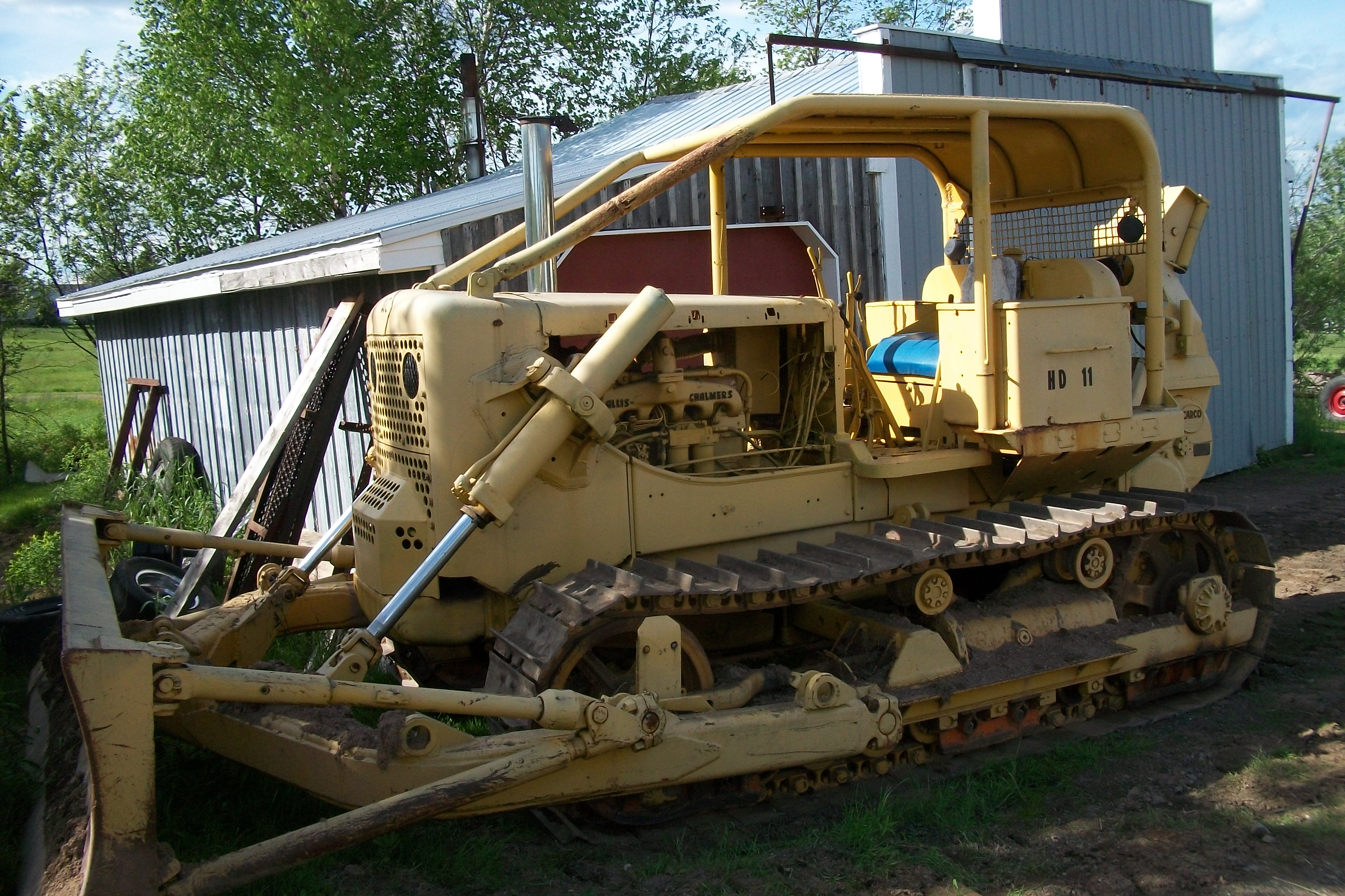

I HAVE AN HD11F. THE TRACTOR HAS AN 11000 ENGINE IN IT. IT HAS AN AMERICAN BOSH INJECTION PUMP. FUEL IS LEAKING INTO BASE OF ENGINE. ANYONE ELSE HAD THIS PROBLEM AND HOW TO FIX. THANKS.
