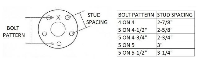

 Ok, going to get a spare set of wheels and tires for my D-15, Series II.  It has 5-lug rims and  came with 6.50x16's.  I need to get the same bolt pattern and the right wheel width.  If I mesasured correctly , it measured 5" from center of ist hole to far side of 3rd hole which should make it a 5 on 5 i think. Tires are on so cant measure wheel width accurately but tractor data for d-15 says 4.5", at least for series!,  Said nothing about series II width.  Would 4,5 be right for 6.50 x16's?  They didn't appear to be an option with the series 1 (only 5.50x 16).

if you GOOGLE D15 front rims, you normally see that the front were 4.25 x 16 inch 5 bolt on the EARLY tractors and 4.5 x 16 6 bolt on the later...
i think there was a 5.5 x 16 inch rime, 5 bolt for the early D17.
