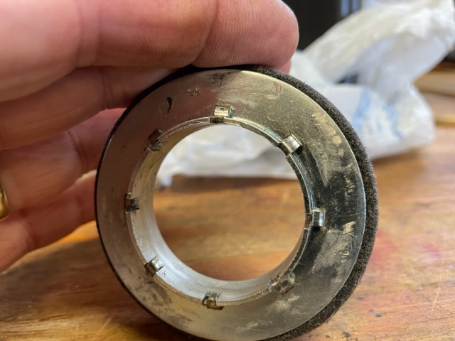

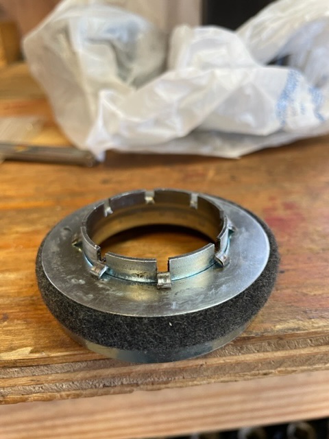

Repacking the front wheel bearings on the D12 series 3. Decided to replace the seals. I never saw a seal like this and I am unsure the proper way to install it. I assume that I should drive it on the spindle and the hub turns against the felt. I’ll try to post a few pictures.

The Allis P/N for that style Seal is 207365.
From the Allis Parts Catalog it appears Allis used that Style Seal
on Ser. I and Ser. III.
From the picture it appears that the Seal installs to the bottom of the front
Spindle with the Outer Diameter Seal Portion facing outboard towards the Hub.
It appears you would have to press the Seal on to the Spindle.
The Seal would remain Stationary and the Hub would turn.

Looking closer at the Picture, that Seal may face inboard.
Perhaps do a dry run by assembling the Hub and Bearings to the Spindle to be sure.

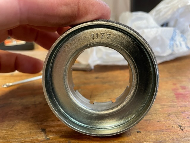

Perhaps you could verify for Avery which way the Seal faces.
G
Points: 5271
Post Options Post Options   Thanks (0) Thanks(0)   Quote PaulB Quote  Post ReplyReply Direct Link To This Post Posted: 18 Mar 2025 at 1:49pm
The side with the 1177 mark goes on first.

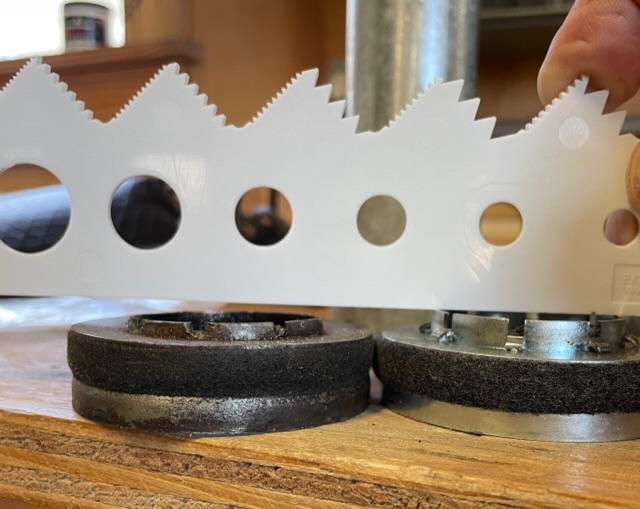

Ok. Thanks. I believe I can build something like that. I tried a 1-1/2” pipe collar/sleeve and it is slightly smaller than the OD of the seal. I can probably reduce that to a smaller diameter pipe that will be slightly larger than the spindle diameter and cut to length. Thanks again for all your help. I did notice the new seal is thicker in area that goes on the spindle. I suppose the old one is worn from years of use.
