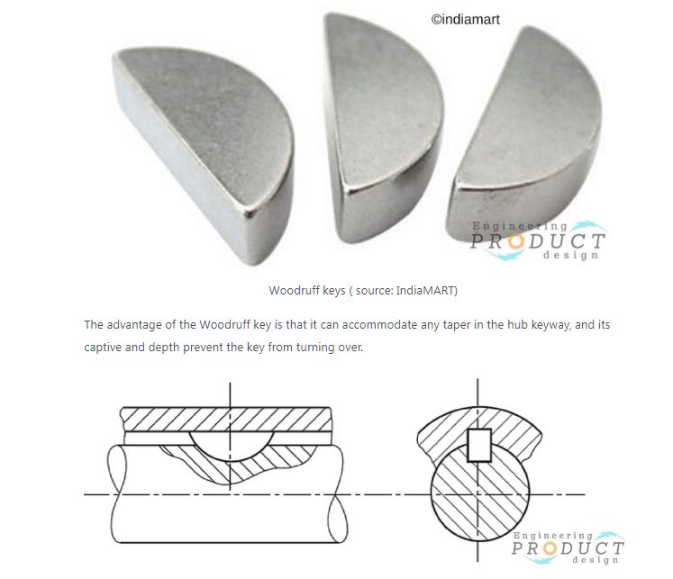

Post Options Post Options   Thanks (0) Thanks(0)   Quote steve(ill) Quote  Post ReplyReply Direct Link To This Post Posted: 02 Sep 2023 at 8:33am
One thing that seems downright deficient though, is the connection between the pump shaft spleen and it's receiving  groove on the coupler. The shape of the spleen on the pump shaft is triangular (like a shark fin), but the receiving groove on the coupler is kind of shallow and rectangular, so only, maybe, a 1/4 to a 1/3 of the triangular spleen can get inserted into the groove
i think you are talking about a half moon KEYWAY...

Points: 8981
Post Options Post Options   Thanks (0) Thanks(0)   Quote SteveM C/IL Quote  Post ReplyReply Direct Link To This Post Posted: 03 Sep 2023 at 8:08pm
Boy Steve! Im glad you could read between the lines cause it made no sense to me!
