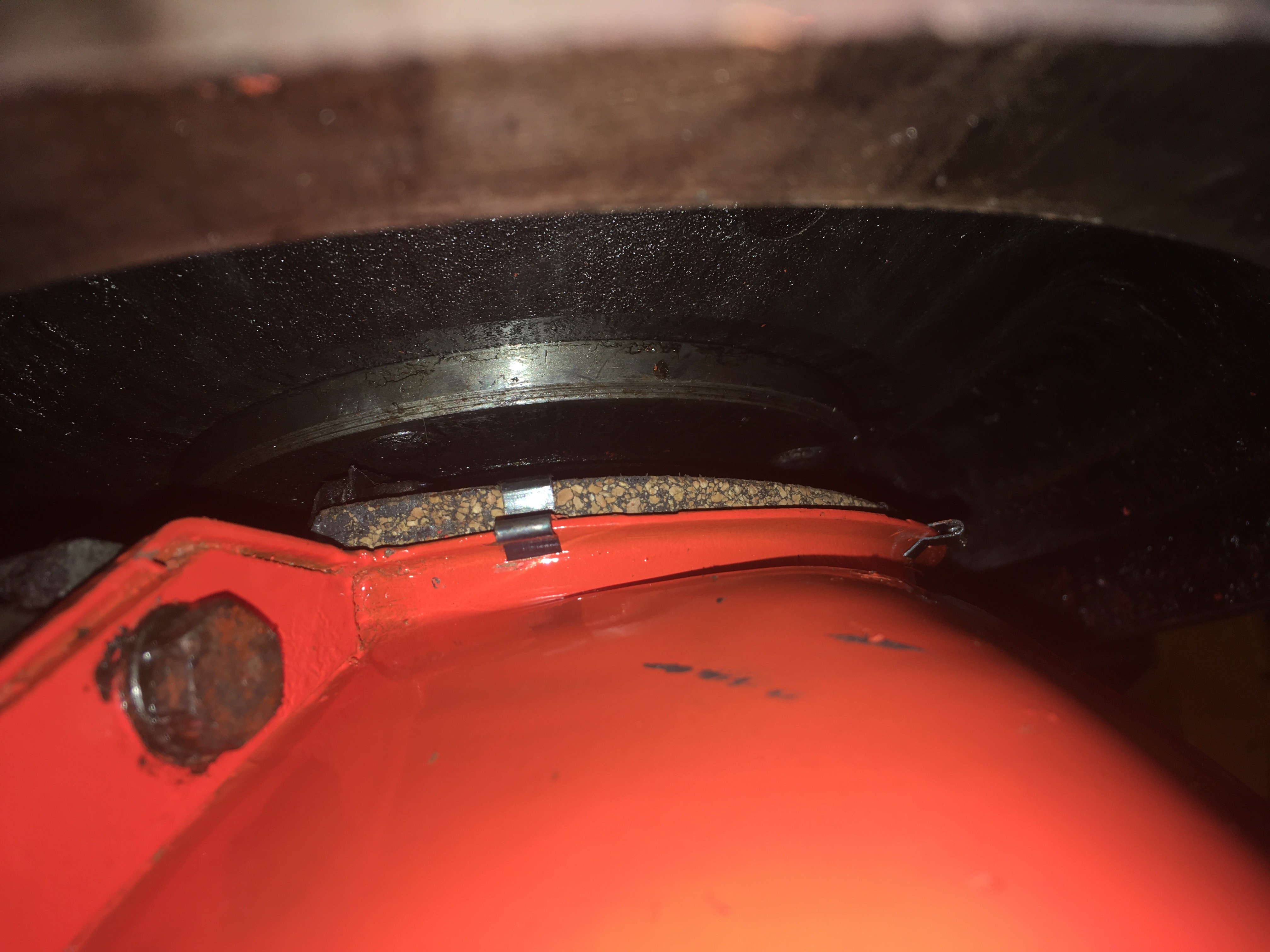

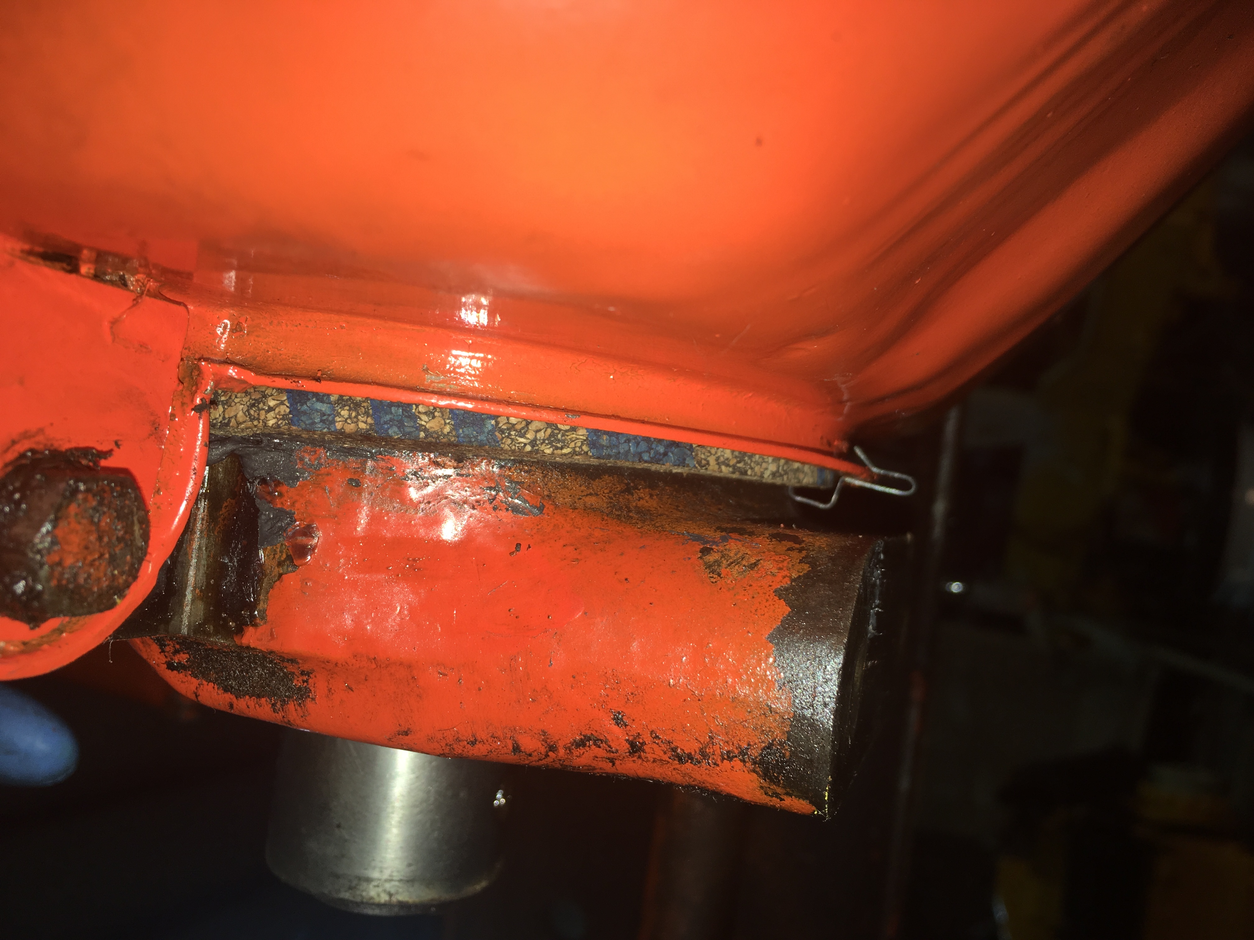

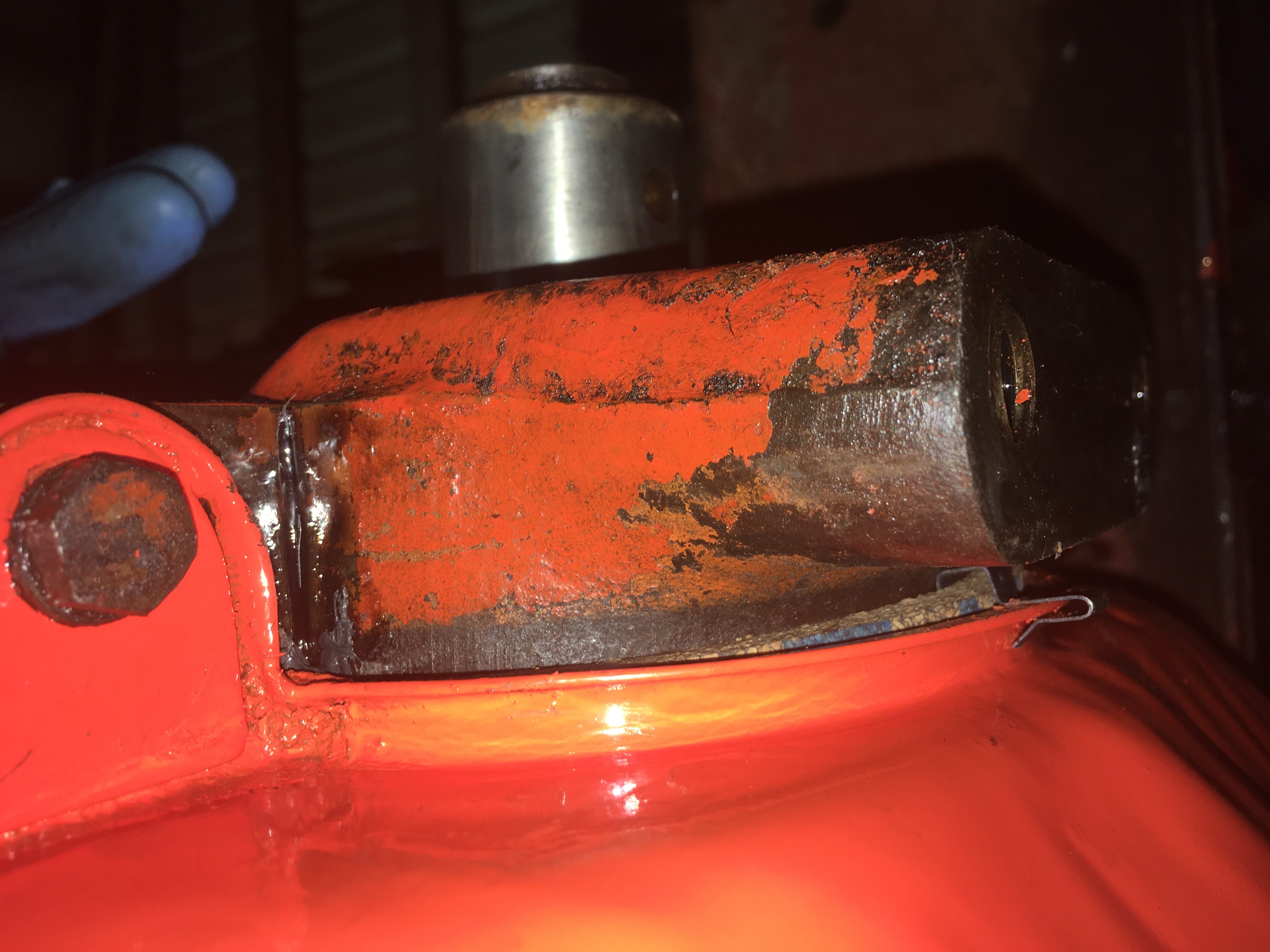

So I got the pan back on tonight and managed to get the rear gasket off center. There is more coming out of the back on one side than the other maybe 1/4” difference. Did I screw up and going to have to take it back apart to re center it. If so I would probably need a new gasket set again.
WD45
IH Cub Cadet 149,1650,1250
#2 Cart, IH#2 Tiller
Points: 8448
Post Options Post Options   Thanks (0) Thanks(0)   Quote Sugarmaker Quote  Post ReplyReply Direct Link To This Post Posted: 15 Jan 2019 at 10:36am
Good job getting the pan back on! That rear gasket is fairly wide so it might work and seal Ok as is? Probably only one way to find out. Or you could take a picture and let folks give opinions?

Post Options Post Options   Thanks (0) Thanks(0)   Quote Allis Wd45 Quote  Post ReplyReply Direct Link To This Post Posted: 15 Jan 2019 at 12:08pm
I did end up lowering the back of the pan because I couldn’t get the flywheel cover back into place with the pan up. I tried to get the gasket in a little further but it is in pretty much the same place. So it must be correct. The front I’m not sure of yet.

Chris, I had to drop the rear of the pan because I couldn’t get the flywheel cover back on I centered that gasket as best I could. I left the front alone because when I loosened the pan the sealer already seemed like it was cured, so we’ll see what happens. Now waiting on the thermostat bypass hose and fan belt from agco.
