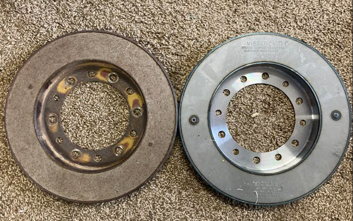

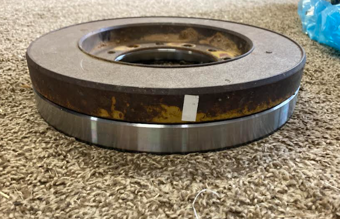

I decided to give it a try, so I purchased a Vibratech dampener for a Detroit 71 series. As far as I can tell, it's a perfect match. Attached are a couple photos of the old and new, plus one photo of the old one cut open in case anyone was wondering how much space there is between the inner ring and the outside. Not much room for fluid, but then again, this isn't exactly fluid any longer.

Now, you can see why we've always been told to handle with care !! There cannot be any dents or physical damage of any kind to the outer shell or the damper is junk because the donut cannot float inside the silicone filled shell.

Got it painted yesterday, and installed tonight. What a difference! Before I could run at 1/2 throttle or above and the top of the exhaust stack would vibrate what seemed like 1/8” side to side from center, although that’s just a guess and it may not have been that exact. After installing this new dampener, I ran it all the way to full throttle and I couldn’t tell any movement in the exhaust pipe now. I’ll note that I don’t have any other warning signs of a bad dampener like broken alternator or A/C compressor brackets. I just did this as a preventive measure given that I’m sure the old one was original with the yellow primer and maroon paint on it, and I’m glad I did it.

If the one you cut apart didn't have any gel like goo inside of it, it was BAD !!!

You are correct, it did not have any gel-like fluid left. But I wouldn’t have known had I not cut it open, so it would’ve been rendered bad at that point, too, regardless. Just glad I did it. A lot cheaper than a broken crankshaft.
