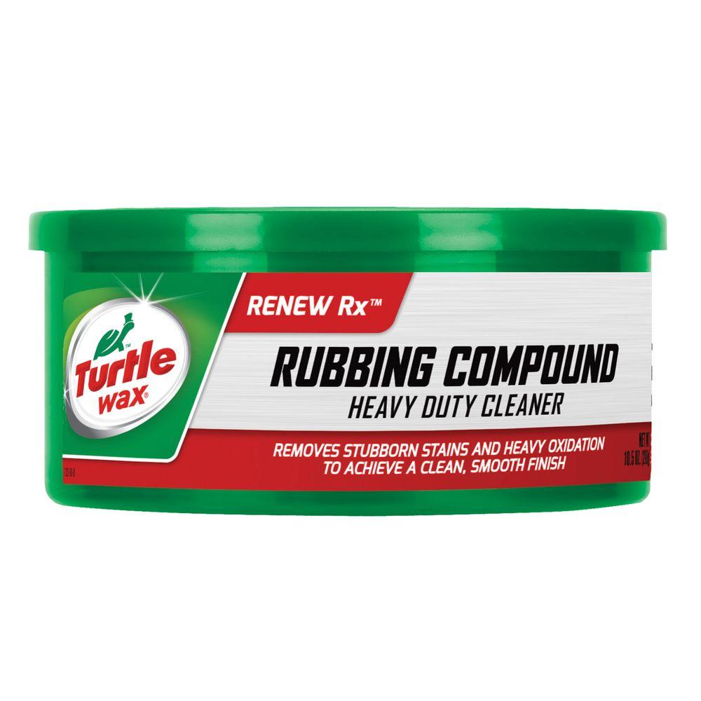

I've had pretty good results with this.

The Turtle wax rubbing compound works great. Try using a water soaked sponge & liberal amounts of the rubbing compound and apply it like a wax job(small circular motion). As your sponge gets dirty, dunk it into a fresh bucket of water & wring out the dirt(dirt/chalky faded paint, etc). Like a waxing, rub off the dried rubbing compound residue with a clean inside of an old cotton sock. Do as many rubbing compound applications as it requires to remove old faded chalky paint (2-5 applications?)
Then, using a good quality wax, give it a "deep waxing job"(slow small circular pattern rub that covers a small area). Don't be in a hurry. Let the wax job cure/dry and remove it's residue with another clean cotton cloth. Enjoy the revived old AC orange paint luster!

We need some before and after pictures too!:) I just used the turtle wax rubbing compound on the hood/ grill of the Jubilee. We ahd been using the tractor for brush hogging and it had set out for the summer. I was very pleased on how it cleaned up.
