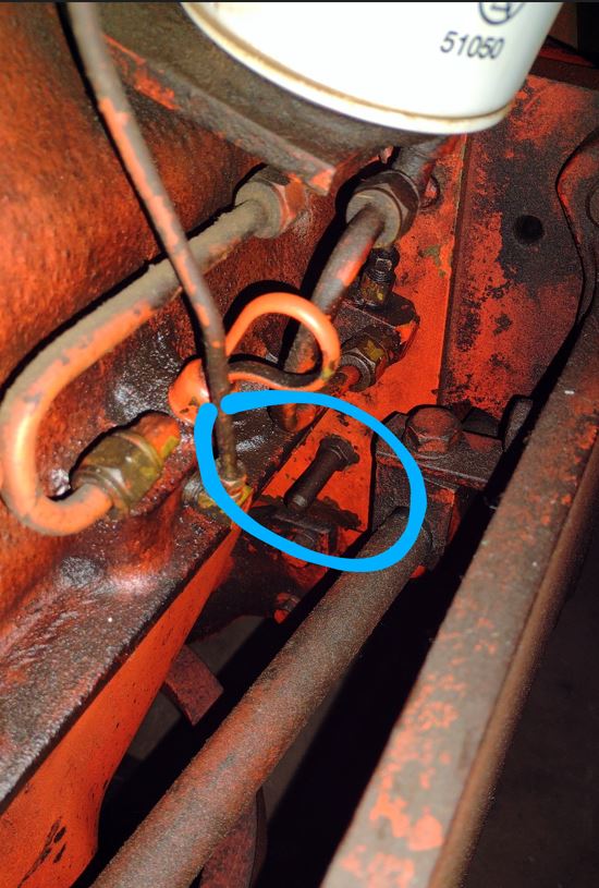

I believe the timing pin is for the 'D' series diesel tractors and not the wd45 diesel.
I have a Series 2 D15 diesel with the timing pin. If I remember correctly you can unthread the pin then turn it around and it goes through bell housing plate and into the flywheel locking it into the correct position.
Here's a pic of the pin on the left side of the D15.

Points: 5465
Post Options Post Options   Thanks (0) Thanks(0)   Quote AC720Man Quote  Post ReplyReply Direct Link To This Post Posted: 25 Oct 2023 at 8:59pm
That is correct. Easiest diesel to time. I’m not sure why it wasn’t carried through to other models also. I guess the D15,D17, D19 were the only ones? I can only say that for sure on a series 1 D17 since I have one. D19 had the same Buda engine with a turbo. Not sure though. Sure makes it easy to time, just verify the marks line up in the timing window of the pump and your on the money.
