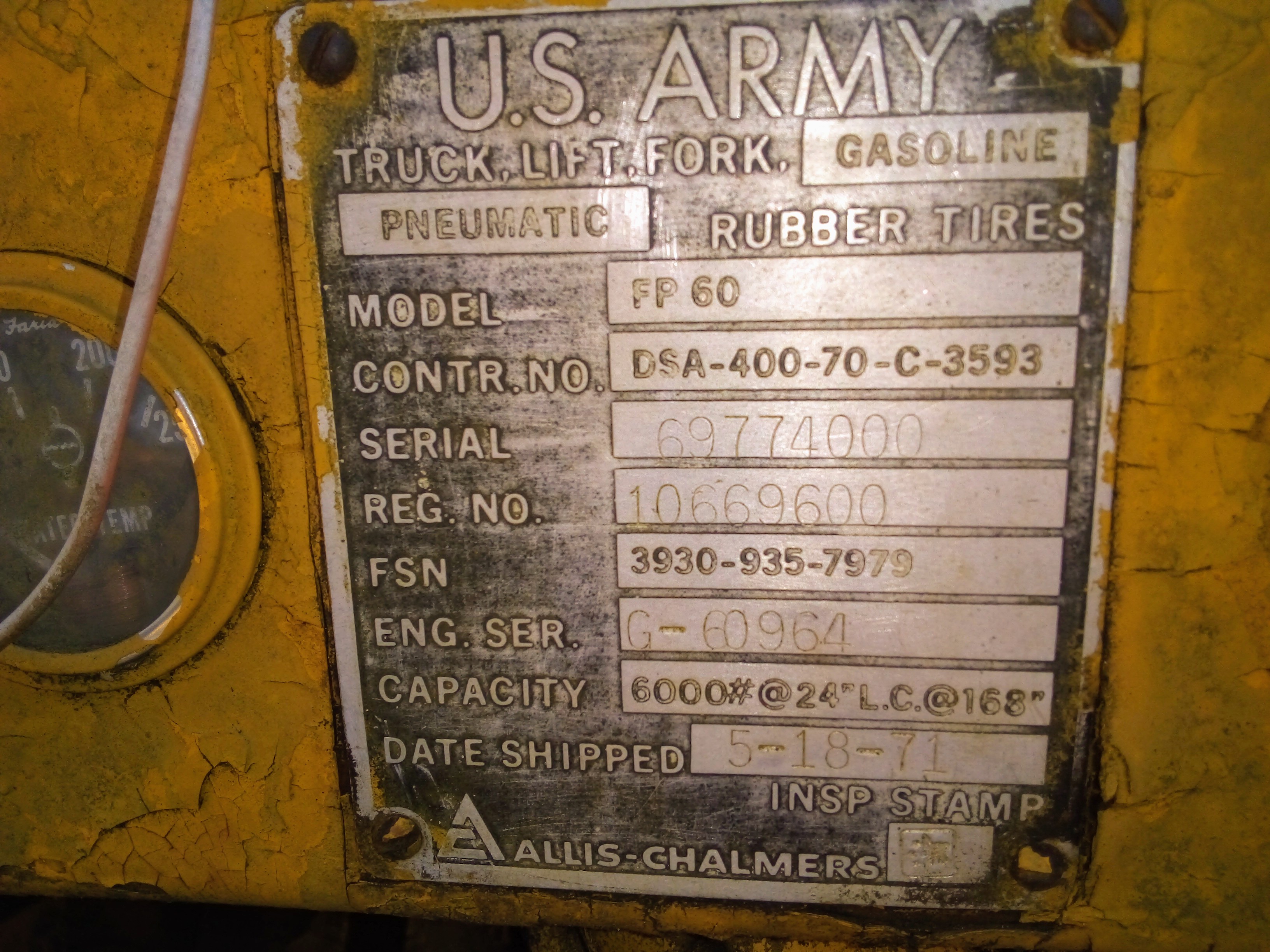

Need help with the kind of engine in FP 60 forklift
Points: 25214
Post Options Post Options   Thanks (0) Thanks(0)   Quote jaybmiller Quote  Post ReplyReply Direct Link To This Post Posted: 26 Jan 2021 at 5:37am
hmm. I'm guessing it'll be a 6 cylinder, either gas or diesel. At 6000#,probably not propane. If you have the 'tag info', that'll help, as well as fuel(gas,diesel,propane).
www.liberatedmanuals.com ; has 100s of AC forklift manuals for free, yours is hopefully there(sniff..I couldn't find mine ,FPD50-24-2PS,sigh...)

Post Options Post Options   Thanks (0) Thanks(0)   Quote Howard the duck Quote  Post ReplyReply Direct Link To This Post Posted: 26 Jan 2021 at 6:45am
Points: 25214
Post Options Post Options   Thanks (0) Thanks(0)   Quote jaybmiller Quote  Post ReplyReply Direct Link To This Post Posted: 26 Jan 2021 at 6:53am
found these...
there's a few more on the site...
good news it's a gas engine ! maybe a G-226 ?

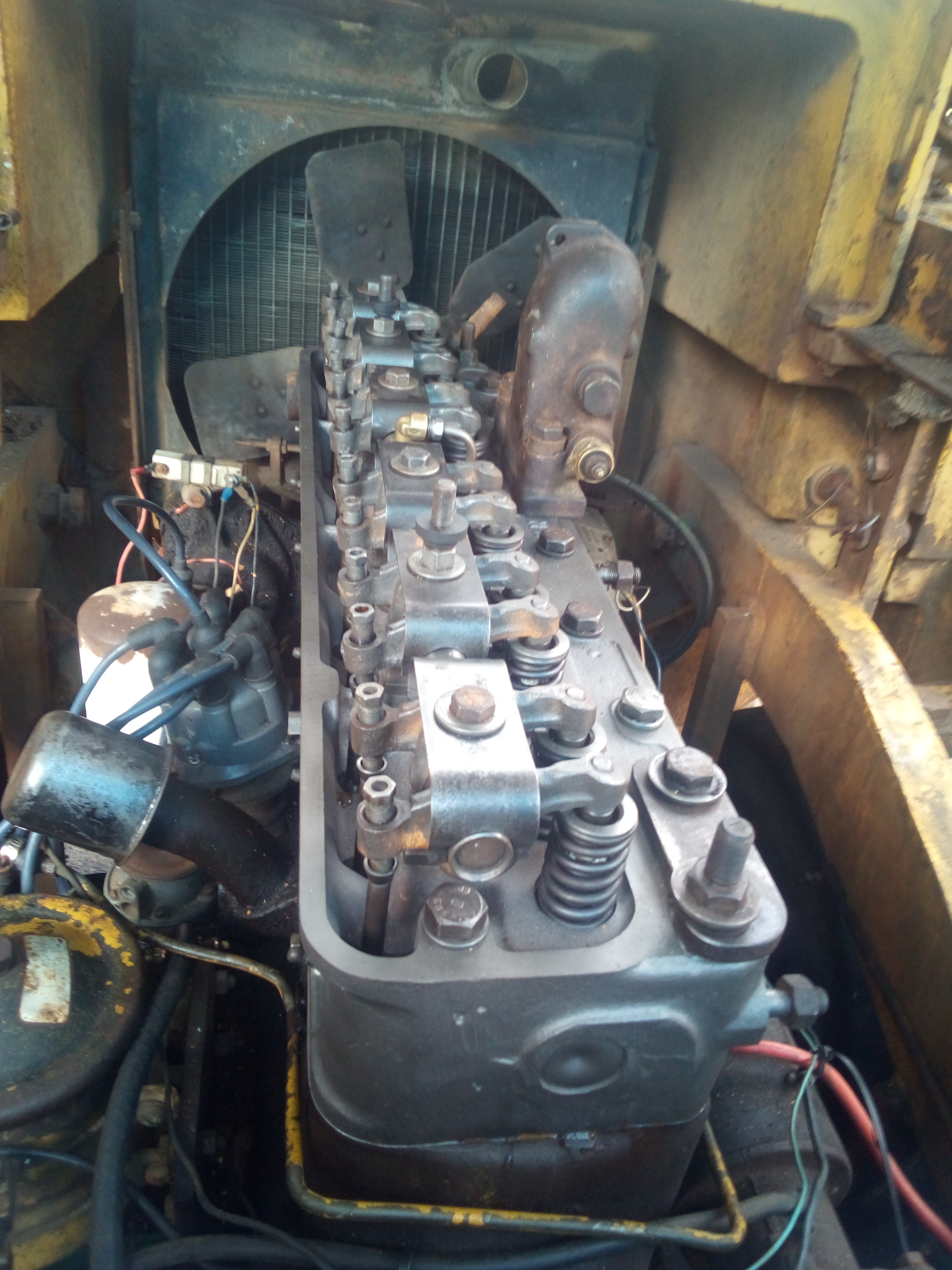

Post Options Post Options   Thanks (0) Thanks(0)   Quote Howard the duck Quote  Post ReplyReply Direct Link To This Post Posted: 26 Jan 2021 at 7:15am
Calvin Schmidt View Drop Down
Location: Ontario Can.
Points: 4582
Post Options Post Options   Thanks (0) Thanks(0)   Quote Calvin Schmidt Quote  Post ReplyReply Direct Link To This Post Posted: 26 Jan 2021 at 10:01am
Engine will be A-C (Buda) G-230

Thank you Calvin! Do you know where I can get parts.
Points: 4582
Post Options Post Options   Thanks (0) Thanks(0)   Quote Calvin Schmidt Quote  Post ReplyReply Direct Link To This Post Posted: 26 Jan 2021 at 7:15pm
What do you need ? AGCO farm dealer might be able to help. Same engine as a Gleaner A combine. Parts are getting hard to get. Depends on what you need.

Jay, maybe Ron would be happy to give it back!  The bigger forklifts that have the 6 cylinder engine , the engines are a 230 and are the same as a Gleaner A. Governor will be different. A 262 from a Gleaner C or CII or D19 is externally the same as a 230. The 4 and 5000 lbs forklifts have the four cylinder version of the 230 which is a 153. A 153 is not used in any A-C farm equipment.
