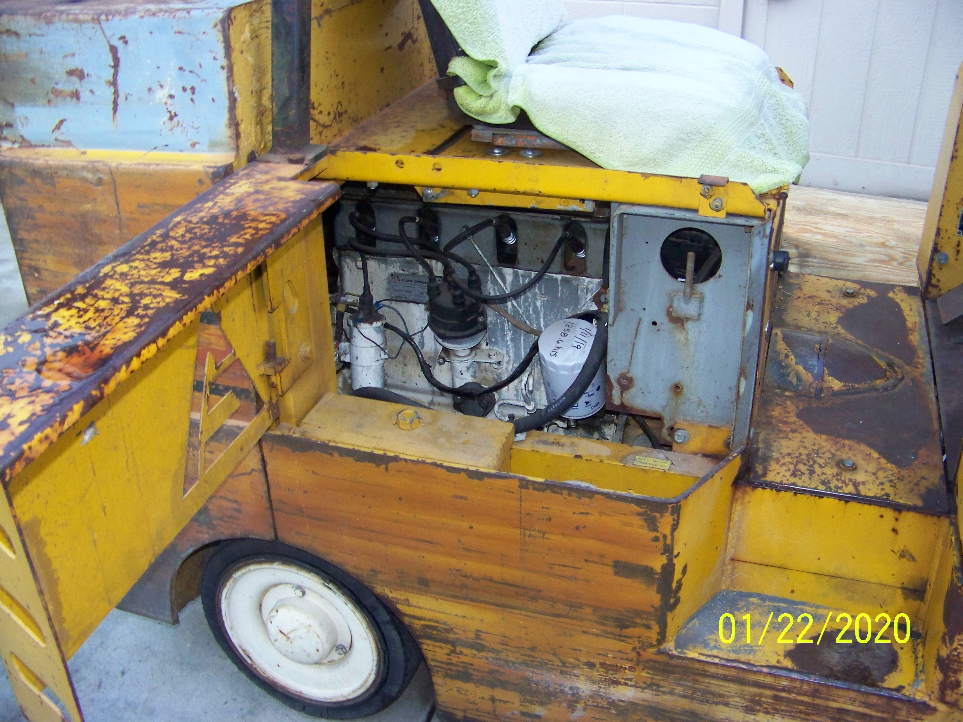

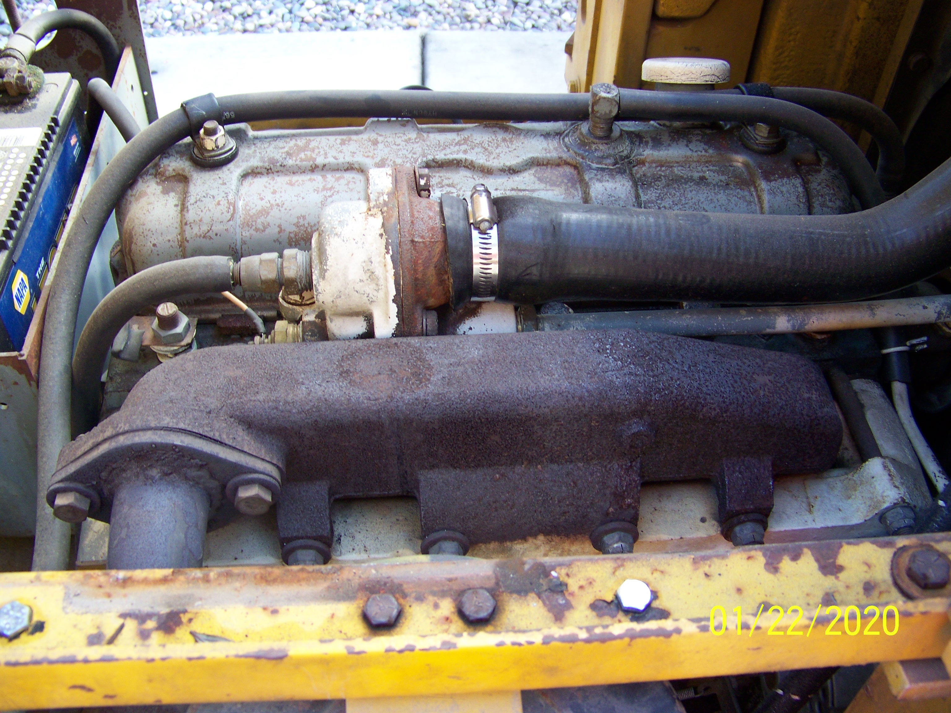

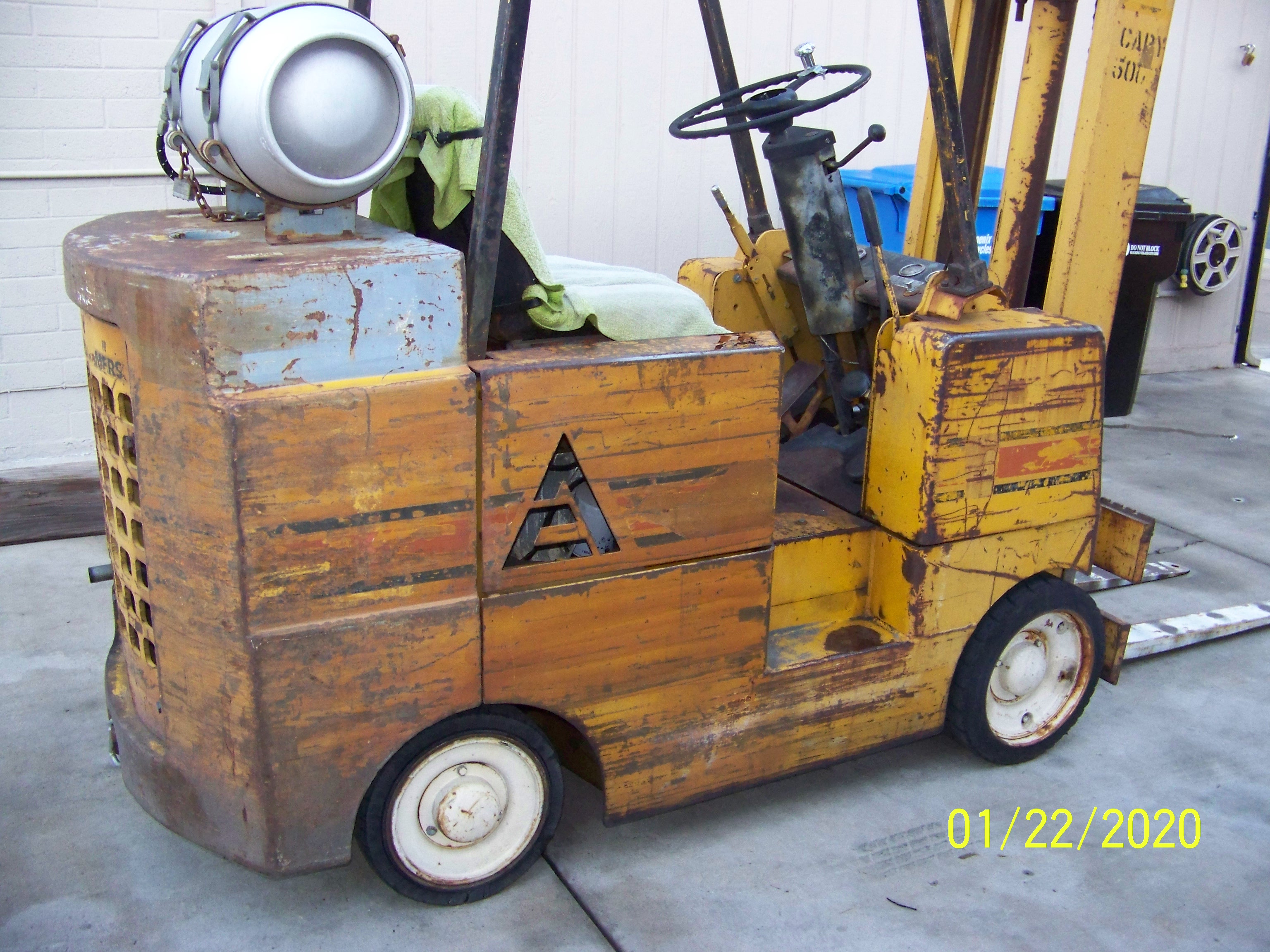

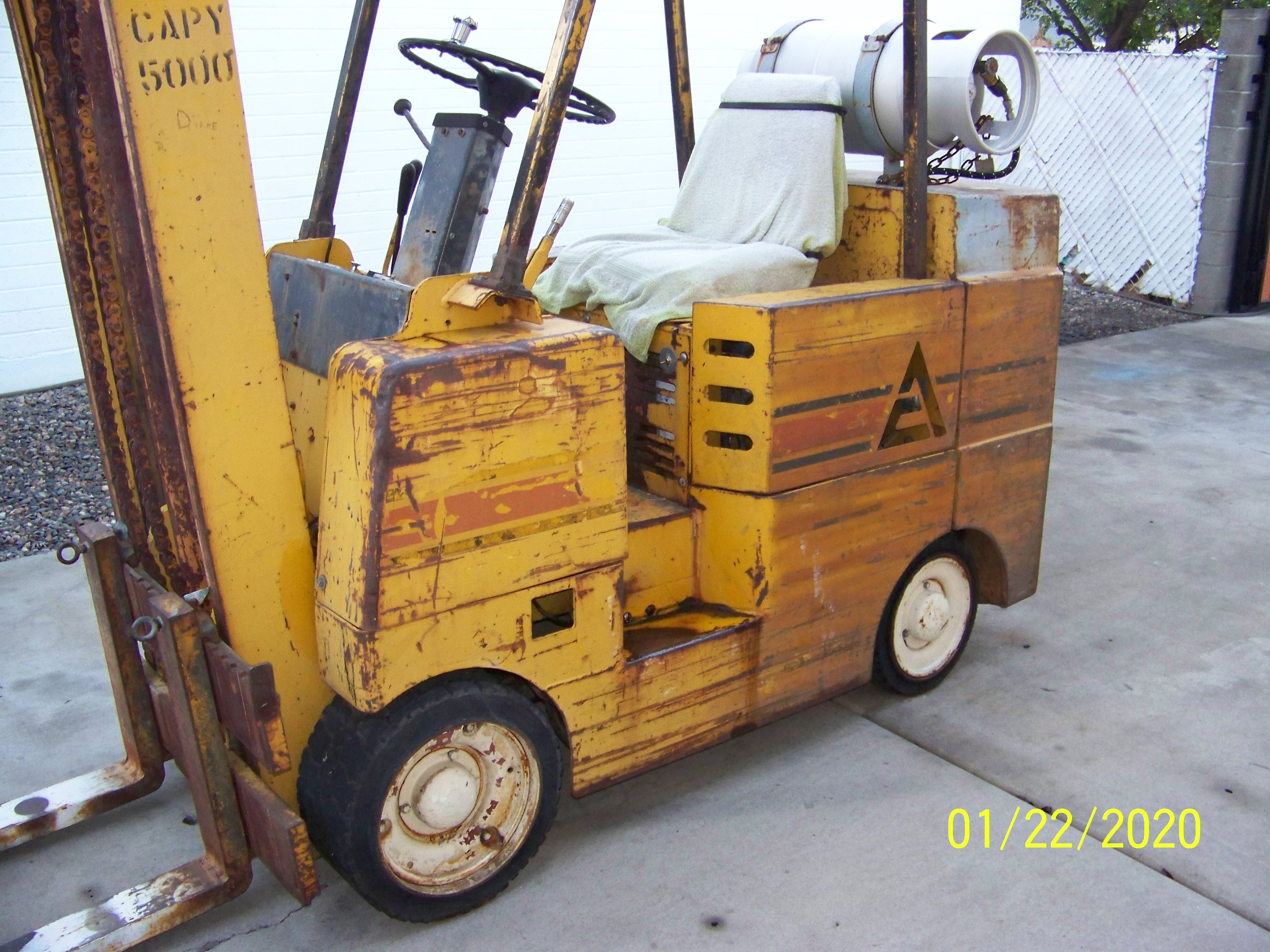

Oh boy here comes another newbee! Hi, my name is Ed. I have a fork lift I need help to identify, the model # tag is gone. Here's what I do know. Eng. tag Mod G-153,  Cat 4516981  S/N G-76411.  Transmission tag  Power shift  WC Ident# 10-01-001  S/N 10146M  Cat# 4821502 mfg by Borg Warner Corp.  I believe the eng is Buda/AC. Here are my questions, Do I check trans fluid with eng running or eng off? What do I use for trans fluid? Mod# of forklift? Approx year of machine? I think the point gap is .022, does anybody know what the dwell is supposed to be?

Guess all the pictures did not uploaduploads/20625/1Cry00_4131_2020-01-22_18-04-36.JPG

hmm.. propane powered, 5000# lift.
you 'should' be able to score a manual from www.liberatedmanuals.com. put 'allis lift' into the 'search box' and it'll limit the list to almost manageable. TONS of neat things there, real easy to get sidetracked.

Yes, do check the transmission fluid with the engine running. If the fluid is red in color it will be Dexron ATF in there. That would be the one to use, if it's not red they may just have put hydraulic oil in it (or tractor hydraulic). The model of your forklift might be ACC-50 if it's a 5000 lbs size. The year could be anywhere from the mid-sixties to the late seventies...
As for point gap I would set it at 18 to 20 thousands of an inch, (would still run good at 22). Please let us know if you get it running well, thanks.

That is an ACC 50 model.  I have the same machine but with the Continental engine
