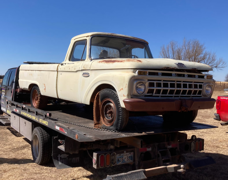

When it was new, it was yellow, but a lifetime of being outside has made it cream color.  It has a 4 speed in it, only thing I would change is make it 4wd!
