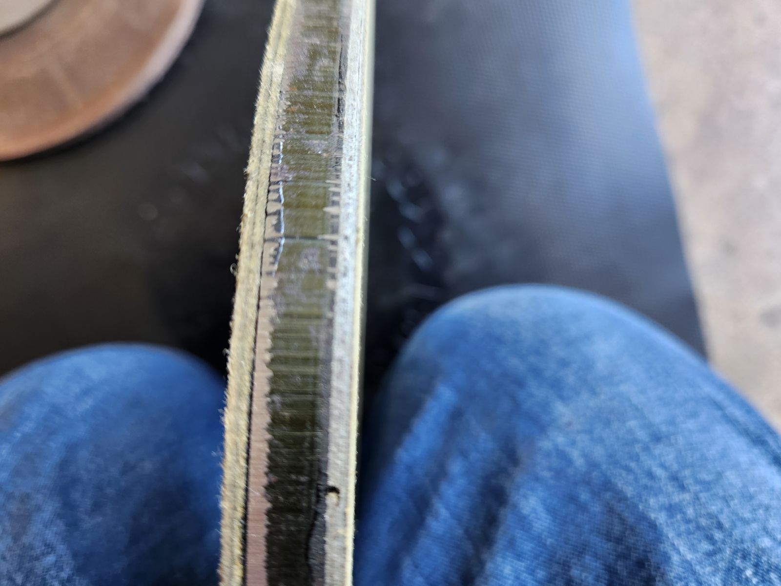

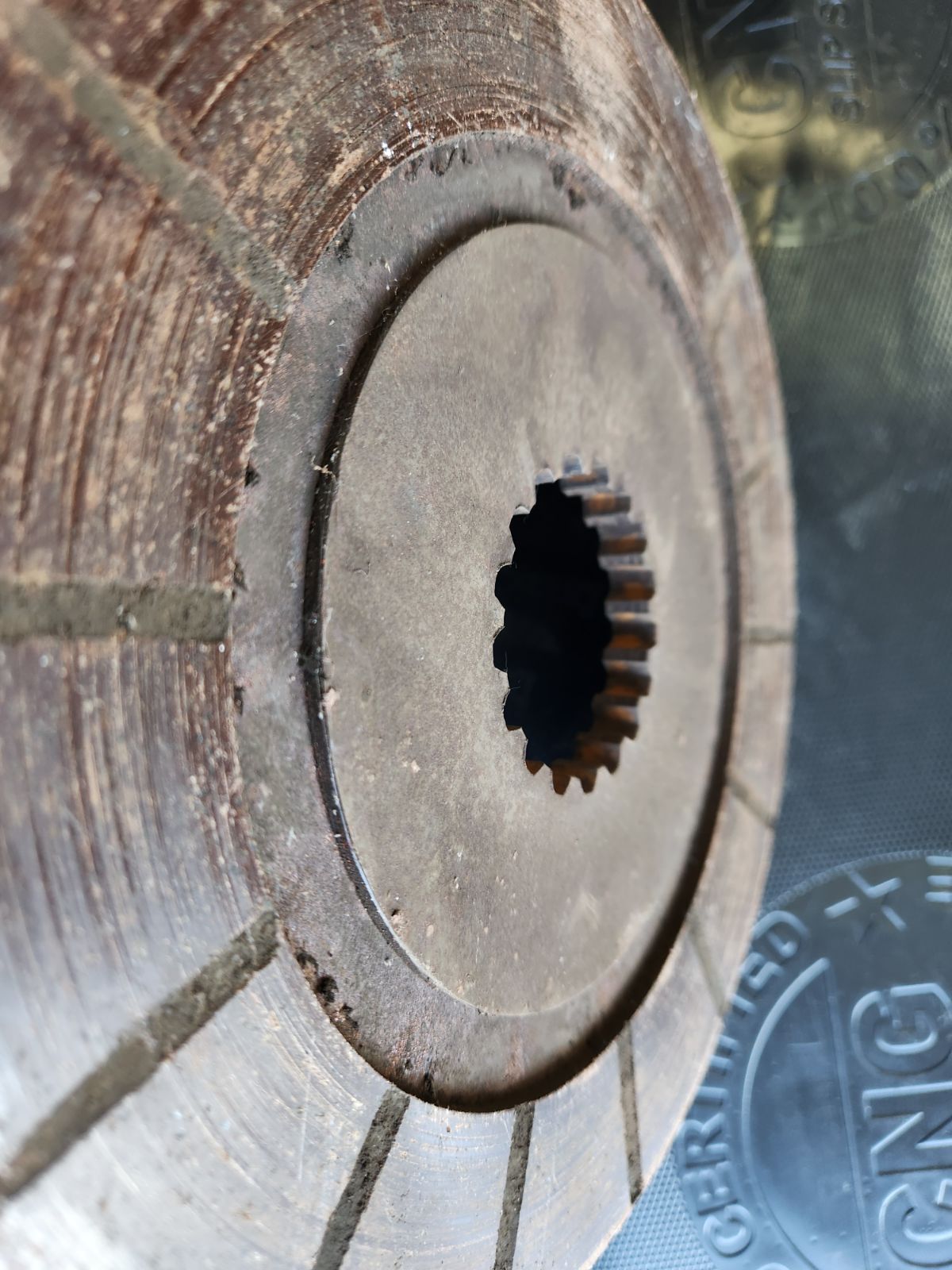

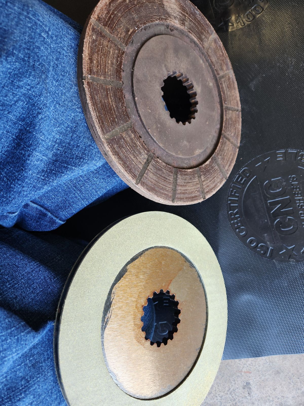

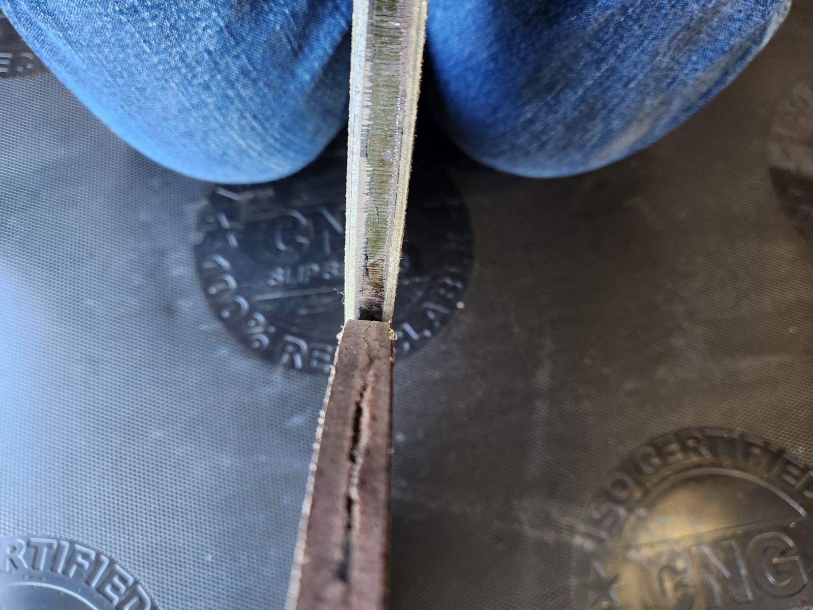

Here's the brake disc pictures injpump ed.

It looks like the actual width of the disc are the same.
But the disc's are not made the same which you can see in the pictures
but the pads are not the same thickness,the tribco pads
are thinner..
