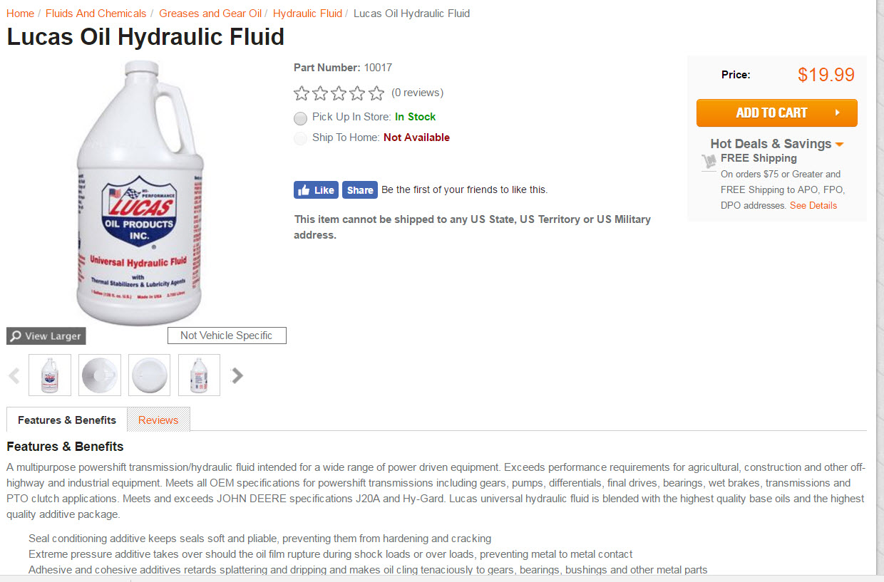

would this be the same???
6http://www.autozone.com/greases-and-gear-oil/hydraulic-fluid/lucas-oil-128-oz-universal-hydraulic-fluid/977490_0_0/

Motor oil. I like Rotella 10w30 it is diesel rated and I feel it is better in the old motors with flat tappet lifters.
Hydraulic oil as long as it saids aw32 on it you are good.
Transmission and final drives I like 80 90 gear oil. My d17 and d15 have run gear oil since new. There was a service bulletin people talk about that said you could run hydraulic oil in them but I like the thicker oil with the bigger gears. In my experience it keeps the transmission quiter.
That photo you showed looks experience to me I would try the local auto parts store. I would buy hydraulic and gear oil by the 5 gallon bucket. Good stuff to have on hand.
The shuttle or power direct clutch and the power steering if you have it use hydraulic oil.
