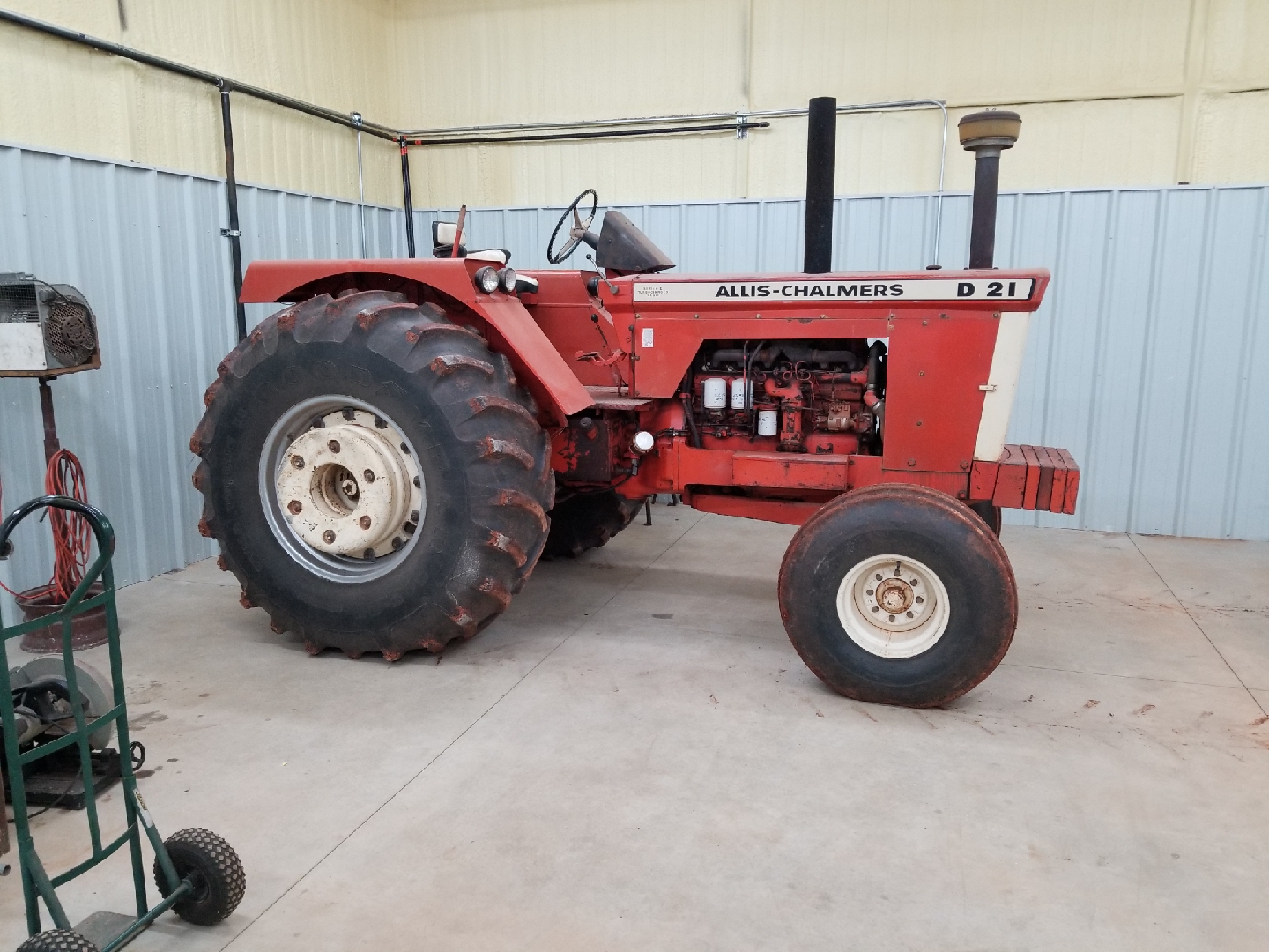

I'm about to split her in two but was curious to see what other members have for splitting stands. I'm going to fabricate some this weekend.

Need some holes in frame rails about where primer pump is. The stand I borrowed had crossmember between rear wheels to put jack on to support engine while fastened to frame rails. Might remove front weights but I can't see how they would be enough to make it front heavy. Just use caution.

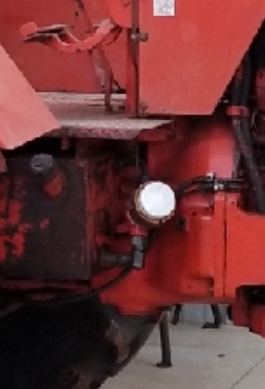

Post Options Post Options   Thanks (0) Thanks(0)   Quote fastallis Quote  Post ReplyReply Direct Link To This Post Posted: 12 Oct 2018 at 8:29am
What is the extra tank mounted under the platform for?
CALEBnOK View Drop Down
Joined: 12 Nov 2011
Points: 618
Post Options Post Options   Thanks (0) Thanks(0)   Quote CALEBnOK Quote  Post ReplyReply Direct Link To This Post Posted: 12 Oct 2018 at 8:46am
The hydrualics are seperate from the rearend. They did that to help solve the rearend failures. Ive seen several d21's around here with this done. I know the mechanic that did them in the 70's and he said they never had another failure after seperating the systems

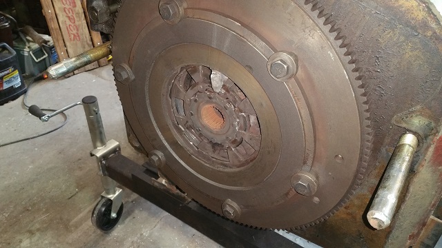

Post Options Post Options   Thanks (0) Thanks(0)   Quote Orange Blood Quote  Post ReplyReply Direct Link To This Post Posted: 14 Oct 2018 at 6:47pm
Never had to split a D21, but if I did, I would just build a frame rail "clamp on" where the frame sat down in a "U" shaped pocket to cradle the frame, and bolts tight on top.  Since that isn't as good as bolting to the frame in two spots on each side, I would add some sort of tie off rod or bar, that runs from the bottom of my front splitting stand up to the front of the frame somewhere.  The stands I built are a two post design for the engine support, one vertical support on each side down to a 4" heavy wall square tube running horizontal under and perpendicular to the tractor with roller jacks on each side.  This really isn't meant to be a picture of the stand, but you can kind of see what I am talking about.
Still in use:

Post Options Post Options   Thanks (0) Thanks(0)   Quote CALEBnOK Quote  Post ReplyReply Direct Link To This Post Posted: 14 Oct 2018 at 8:57pm
Thats about how i planned on building mine.
I want to make them clamp tonthe frame rails but will be adjustable so i can split my 210 later on and split a 190
