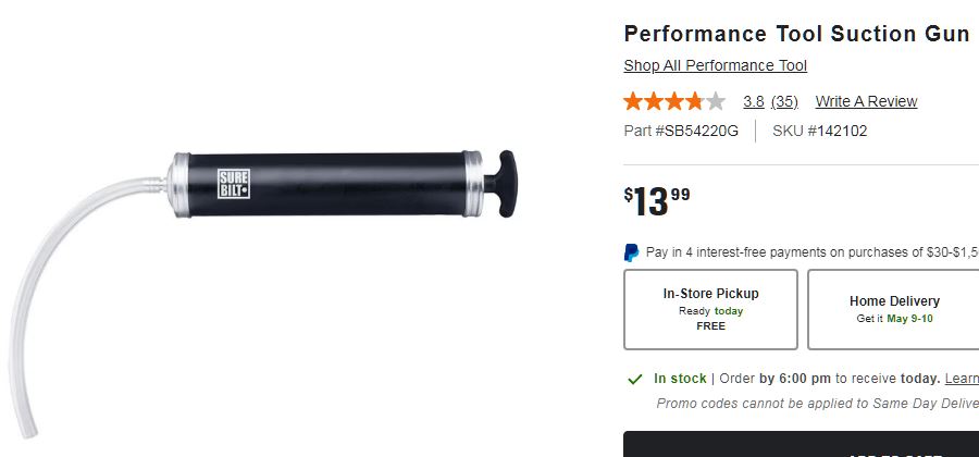

i have used a Rose Gun.. basically looks like a grease gun without a grease tube.. Stick the hose into the fill port and pull back on the rod and it SUCKS the oil out.. Works good on oil or gear lube.. Not so good if it is THICK  or grease... If your seals dont leak and it still has gear lube ( instead of grease) this may work... If the fill is on the SIDE, then i have used a copper tube bent into a  sweeping 90 degree  to get into the hole.

Update - Fill lug is on the side and vent plug is on the top.  Good tip Steve.  Now I an going to price one of those sucker guns.

Post Options Post Options   Thanks (0) Thanks(0)   Quote steve(ill) Quote  Post ReplyReply Direct Link To This Post Posted: 03 May 2024 at 9:10am
Auto Zone, WAl Mart, Farm Store...

Post Options Post Options   Thanks (0) Thanks(0)   Quote Dave H Quote  Post ReplyReply Direct Link To This Post Posted: 03 May 2024 at 9:24am
Thanks Steve - got one ordered from Amazon
