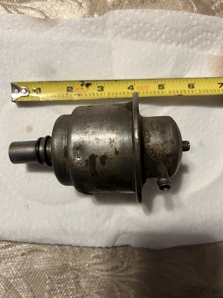

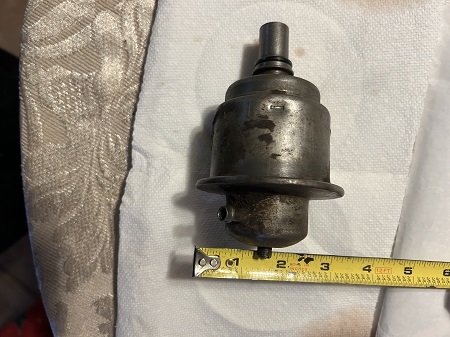

 Well,, I've come to yet  another road block on parts for the One Ton,,,!!Angry
 I had decided to change oil and filter on The TH400 transmission plus the modulator and No problemo getting the correct filter and gasket from Amazon, but that modulator is another problem. I ordered the  modulator that Amazon recomended for for the transmission altho, it don't look like the OE at all.
 The numbers stamped on top are 3027221  plus HRD  plus M2. I run those on my search engine but NOTHING comes up,,,???? Tried those numbers on Amazon and Ebay and again nuttin,!!!!
 Where is ole Steve with that magic Search wand of his when I need his books? The trk is a 1988 GMC  C3500 with a 7.4 (454) and TH400 transmission,,,,,,,,
 HELP,,,,!!!

  pics

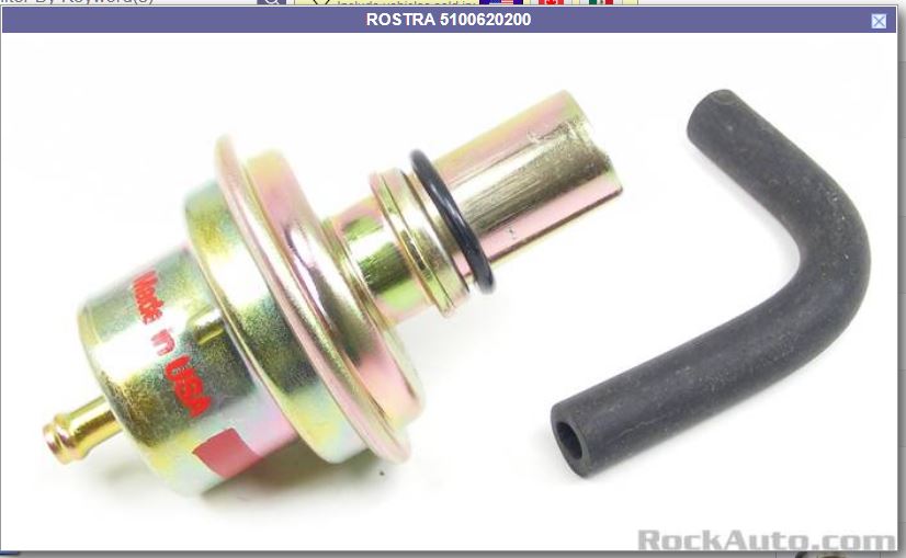

https://www.rockauto.com/en/catalog/chevrolet,1988,c3500+pickup,7.4l+454cid+v8,1034334,transmission-automatic,governor+/+modulator,8500
they call it a GOVERNOR/ MODULATOR if your looking under the C3500/7.4.TM400 catagory... a couple of them say "adjustable".. so they have the screw ( maybe inside the base).

Points: 90826
Post Options Post Options   Thanks (0) Thanks(0)   Quote steve(ill) Quote  Post ReplyReply Direct Link To This Post Posted: 17 Jan 2024 at 8:21am
I dont think the SHAPE is a probleml.. One end fits in the bore and as long as that is the right size, if its round or square i dont think it matters... the hose is one the end instead of the side.... i think the adjuster screw is on the other end, instead of the top ?

Post Options Post Options   Thanks (0) Thanks(0)   Quote desertjoe Quote  Post ReplyReply Direct Link To This Post Posted: 17 Jan 2024 at 8:32am
 Yeah Steve,,I've about decided that you are exactly correct. All the 15,256 modulators I've looked at are ALL shaped the same except for the number of colored strips and none look like what came out of the trk,!! The old modulator also had an adjustment screw to adjust the shift points up or down.
 Amazon has a good "Verify your Part" checker ,,so I guess i'll have to go with that.

The adjuster screw is inside you stick a allen wrench in thur the vacuum line hole.at least thats the way adjustables worked when i did trany work in the 70's and 80's
