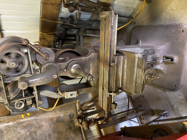

Went and picked it up tonight.
I have it close to its permanent spot. I need a power feed belt and to figure out the power feed then I can back it in a little more.

I need to look in to that. My lathe is flat belt and a drill press along with this mill. This mill belt is really nice but much too narrow.
It works but I don’t think it would handle a deep cut without slipping.
