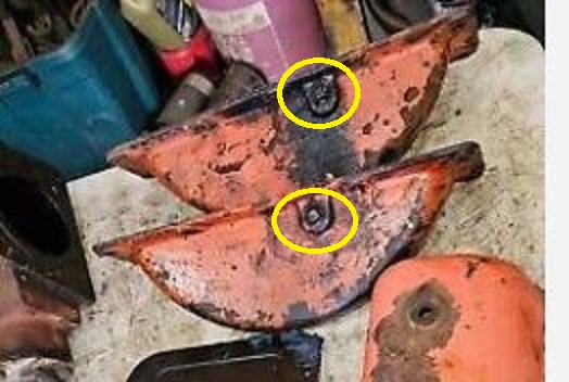

there is a sheetmetal half moon pan on the BOTTOM of the final drive housing.. There should be a 1/2 inch pipe plug on the inner side ( center of tractor) to FILL the pan with about a quart of gear lube... To get it OUT, you remove the pan.. About a dozen 5/16 inch bolts hold it on.. Could be setting inside the rim area depending on how you have the tires positioned.

two oil pans setting on the bench...

those covers can NOT be missing. That is the BOTTOM of the final drive housing setting next to or inside the tire rim.... The TOP SHAFT has the brake and goes thru the transmission housing into the bevel gear assembly. If the SEALS are bad on the top shaft the oil will leak into the upper housing and run onto the ground thru a 1 inch hole on the BOTTOM of the axle housing... There is a seperate seal on the outboard end of the axle for the final drive  housing / gear oil... No, you can not leak other oil into the final drive housing.. Someone just overfilled it..
