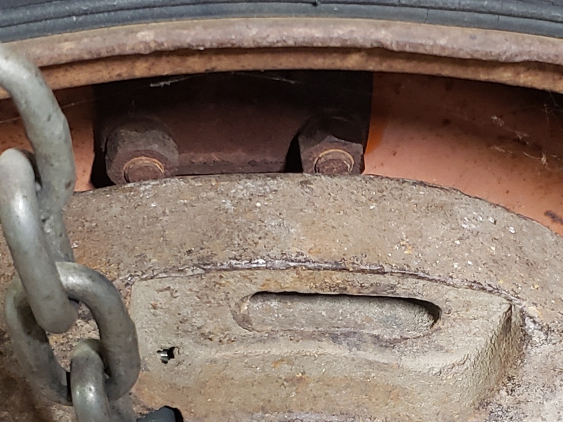

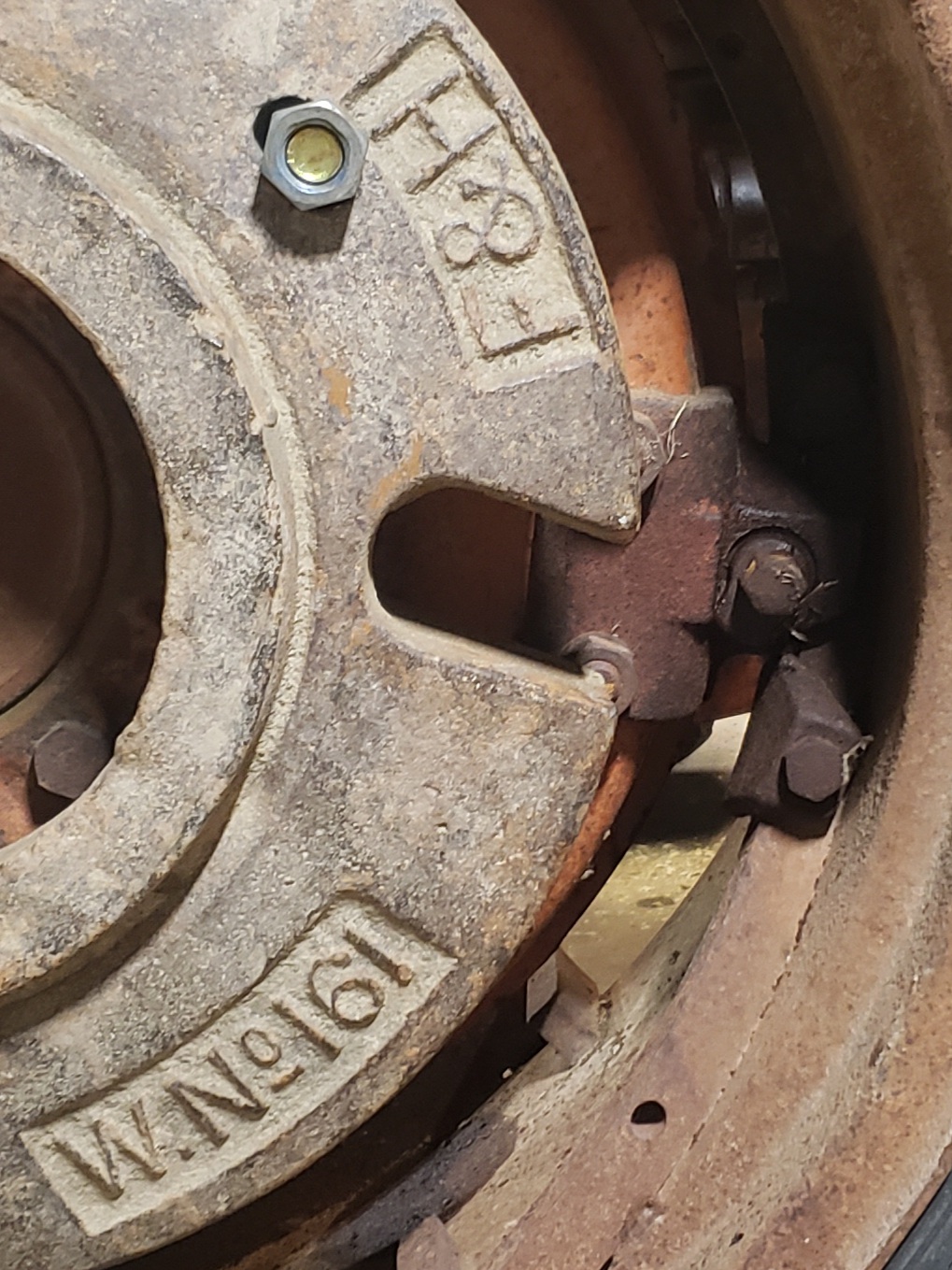

Is there a certain starter weight required for these models? I have a pair of 161 and 6 pair of 161G weights I'd like to put on but the weights hit the bolts holding the eccentrics on the wheel center.

I believe you need to put a 162 on before you can use a 161.

Pretty sure these are 162's. Just bolt-em on like Allis weights. On the 185 I had to use a set of 161's on the inside.
