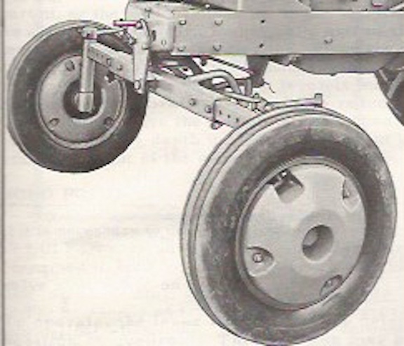

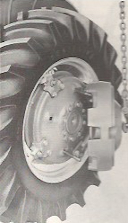

Post Options Post Options   Thanks (0) Thanks(0)   Quote IBWD MIke Quote  Post ReplyReply Direct Link To This Post Posted: 04 Apr 2020 at 9:23am
Here is a pic from the 'Deep tillage tools' manual. Lists the front weights as 157 Lbs., more than twice as much as the more common 'doughnut' weights.
