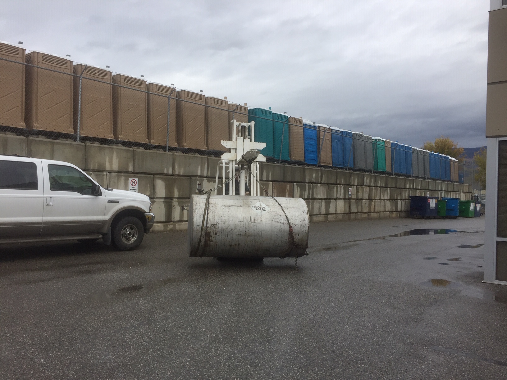

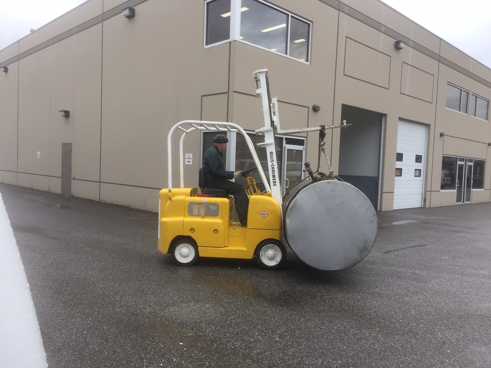

Thought I'd give an update.  I topped the tank off with some fresh AW32 and checked the filter and all is clean.  I stuck a magnetic oil pan heater on the tank and still takes about 20-30 seconds to prime the pump.  After that is works great until you stop using the hydualics, then the prime is lost.  I think it's getting air into the pump intake, so when I get some more time I'll take the system apart and find the cause.:)  Had the old girl out today lifting about 3700 lbs worth of fuel plus tank and she was very stable.  I'll update this thread when I find the cause and the fix.:)  Here's a couple of photos.
