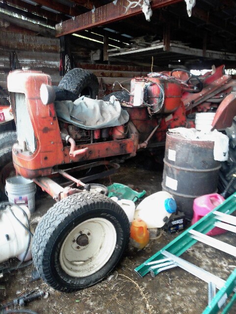

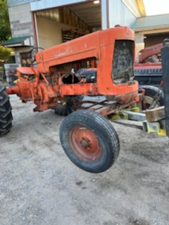

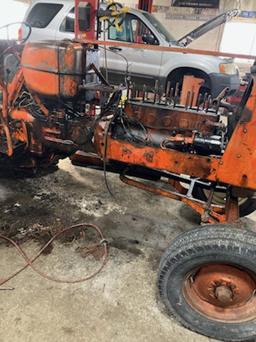

brought this tractor after it was sold to a relative about    1988  and then was only used to bale with until the engine went down in 2012 then got tore donwn at a machine shop the place shutdown and the top end got scraped and tractor went back to their shed and sat until two years ago in may and they called me and told me to come get it its your and you are the only one that will do anthing withit i already had all the origial paperwork and reciepts from when it was newf

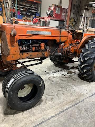

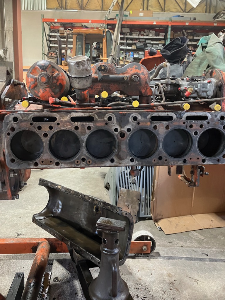

Post Options Post Options   Thanks (0) Thanks(0)   Quote HudCo Quote  Post ReplyReply Direct Link To This Post Posted: 16 Mar 2025 at 5:27pm

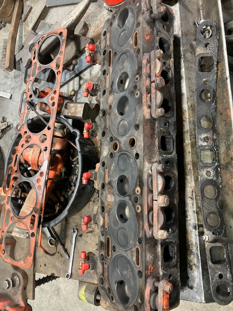

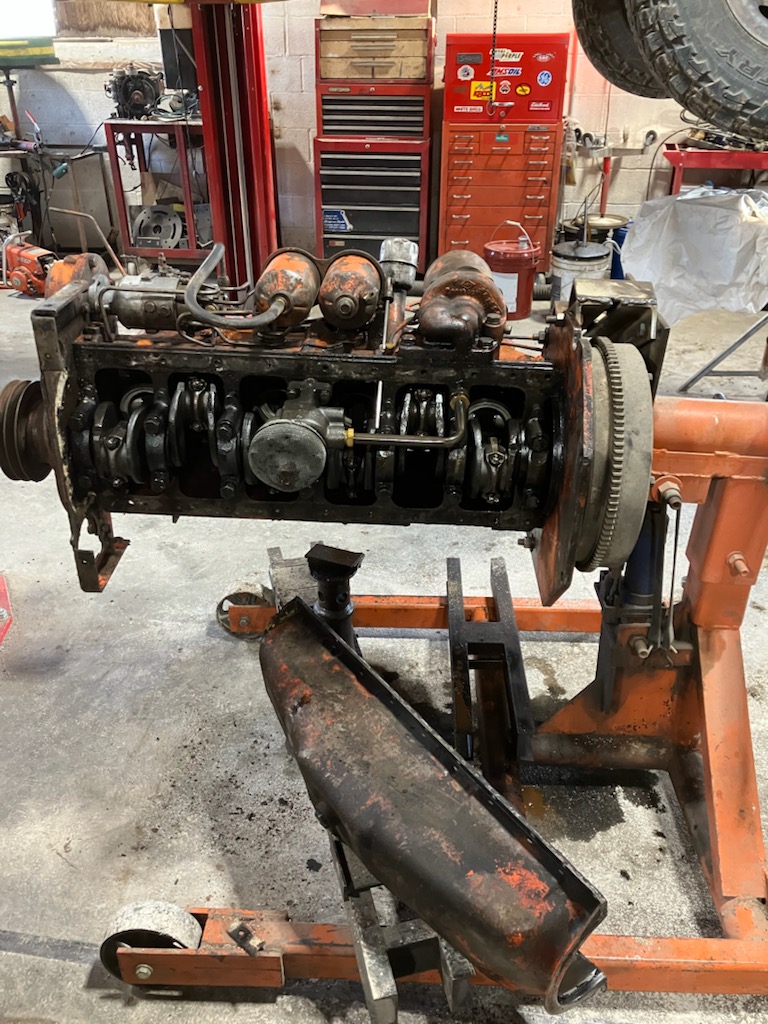

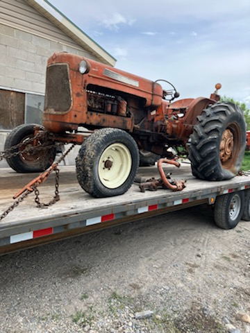

doner engine tractor going out the door but that engingine has blow by so bad it pushes oil out the filler that engine has head bolts mine with the studs sticking up was juast how i got it back so i needed the doner engine for everything from the deck up  much more has been done since those photos

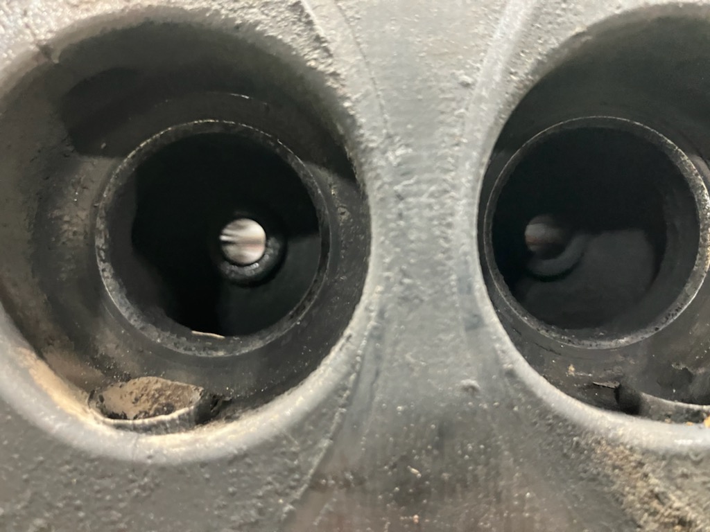

Post Options Post Options   Thanks (0) Thanks(0)   Quote HudCo Quote  Post ReplyReply Direct Link To This Post Posted: 17 Mar 2025 at 10:17am

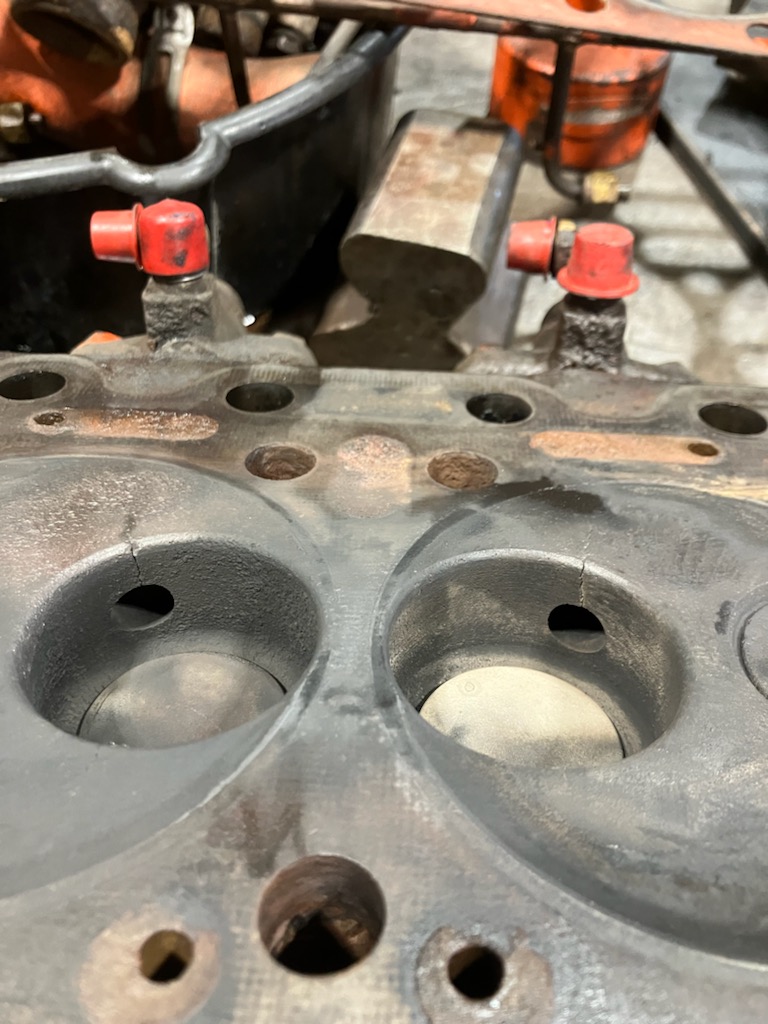

uploads/8753/IMG_1049.jpgcracks above injector holes , how bad is it ? that engine did not leak coolant and did not make compression in the rad.

Post Options Post Options   Thanks (0) Thanks(0)   Quote HudCo Quote  Post ReplyReply Direct Link To This Post Posted: 18 Mar 2025 at 10:37pm

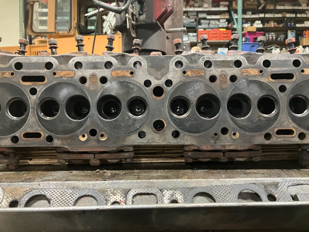

sofar no cracks around the valves or ports but it hasnt been magna fluxed yet

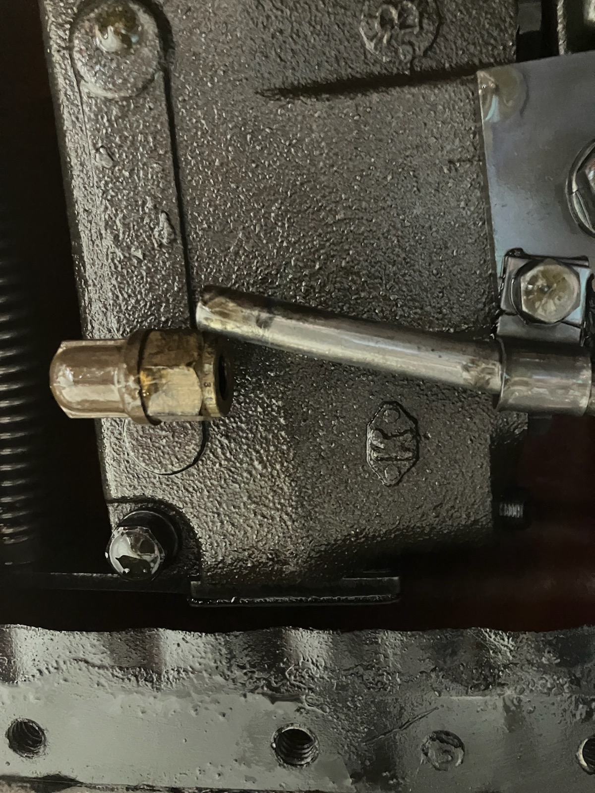

Post Options Post Options   Thanks (0) Thanks(0)   Quote HudCo Quote  Post ReplyReply Direct Link To This Post Posted: 19 Mar 2025 at 10:03pm
tube on bottom of hydrualic pump was disconnected when i took the cover off to check things and replace seals and gaskets also is their suppossed to be a screen ?
Points: 22772
Post Options Post Options   Thanks (0) Thanks(0)   Quote DrAllis Quote  Post ReplyReply Direct Link To This Post Posted: 19 Mar 2025 at 10:30pm
Very early ones did not (should have) have a screen.

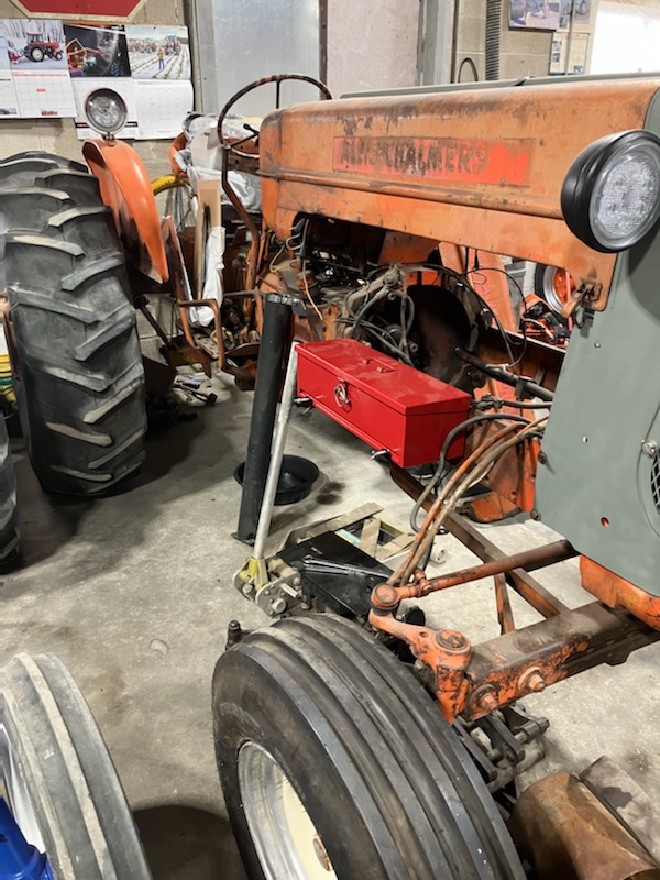

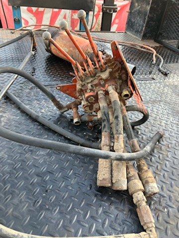

Very nice, YOu've got a 3 spool vavle with it!
HudCo View Drop Down
Joined: 29 Jan 2013
Location: Plymouth Utah
Points: 4065
Post Options Post Options   Thanks (0) Thanks(0)   Quote HudCo Quote  Post ReplyReply Direct Link To This Post Posted: 20 Mar 2025 at 10:09am
the three spool valve came from a parts tractor last fall along with the air cleaner that was missing from mine . was scrapped along with every thing esle from the deck up   what does that tube on the pump do it just goes up and points in to the belt pully side and is just a open tube
Points: 22772
Post Options Post Options   Thanks (0) Thanks(0)   Quote DrAllis Quote  Post ReplyReply Direct Link To This Post Posted: 20 Mar 2025 at 12:20pm
Provides oil for the front clutch shaft bearing and belt pulley gears especially when the nose is up.
