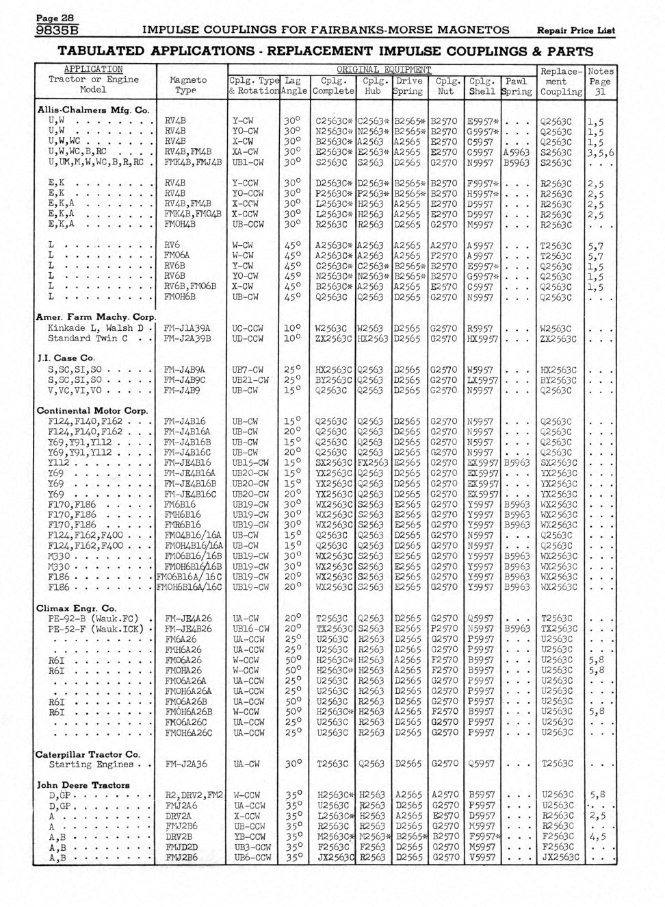

By the way that chart should be added to the information page.
It has excellent data that can be most helpful
