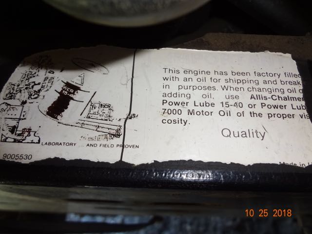

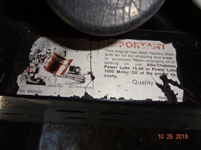

Ron(AB) View Drop Down
Joined: 27 Dec 2009
Location: Alberta
Points: 959
Post Options Post Options   Thanks (0) Thanks(0)   Quote Ron(AB) Quote  Post ReplyReply Direct Link To This Post Posted: 25 Oct 2018 at 1:14pm
HoughMade View Drop Down
Joined: 22 Sep 2017
Location: Valparaiso, IN
Points: 706
Post Options Post Options   Thanks (0) Thanks(0)   Quote HoughMade Quote  Post ReplyReply Direct Link To This Post Posted: 25 Oct 2018 at 2:04pm
Yeah, but still....
1951 B
Points: 21723
Post Options Post Options   Thanks (0) Thanks(0)   Quote DrAllis Quote  Post ReplyReply Direct Link To This Post Posted: 25 Oct 2018 at 2:38pm
BLESS YOU, RON (AB) !!!
ACjack View Drop Down
Joined: 13 Sep 2014
Location: Peoria, Arizona
Points: 275
Post Options Post Options   Thanks (0) Thanks(0)   Quote ACjack Quote  Post ReplyReply Direct Link To This Post Posted: 25 Oct 2018 at 5:15pm
The picture of the decal clears up a whole lot of confusion.

If you look in AGCOs parts book for the 8000 series that decal is in the decal section. Page 176 for the 8030.

That decal is on my dads 185 too.
