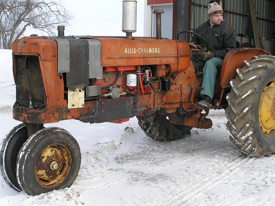

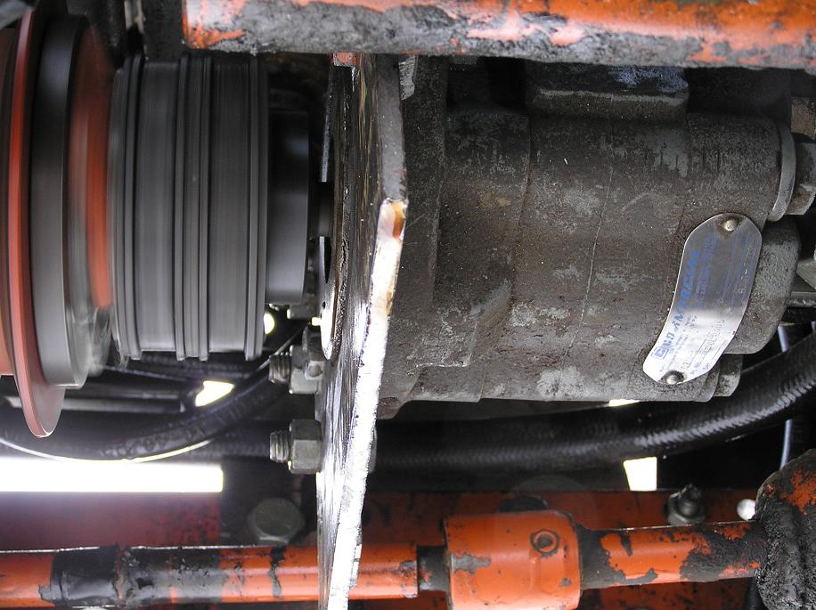

Drove the unit outside on it's own power. We didn't notice anything bad.
I extended the frame 20 inches for the longer engine and a hydraulic pump on the front of the engine.
If an extended hood is good on a Peterbilt, it should  be OK on an Allis Chalmers?
Picture of the tractor and picture of the drive and pump, running.
