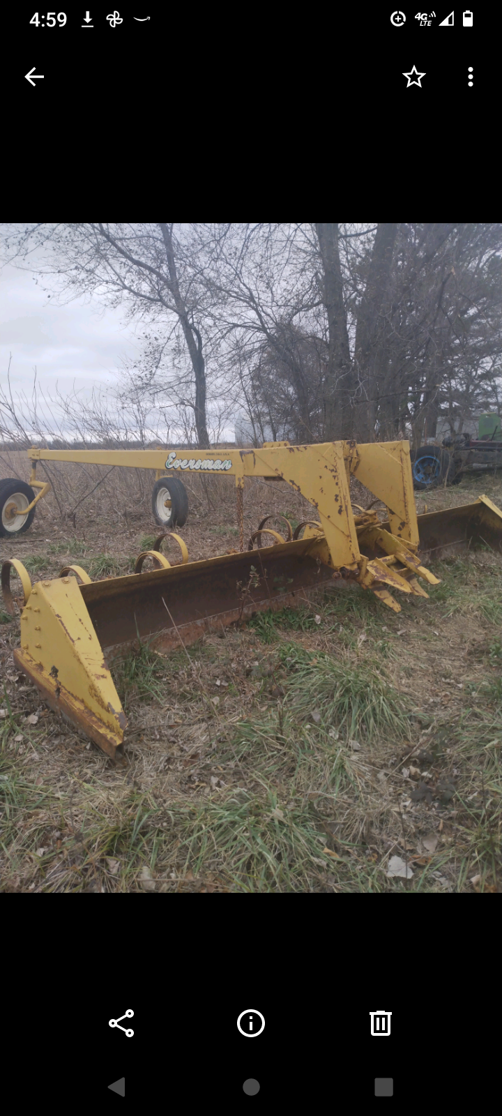

I'd posted a while back about needing to level some ridges and deadfurrows out of a few fields. I ended up getting an Eversman TM-2 landplane on a consignment auction. The only problem is that I am having a hard time figuring out exactly how to hook it up to get the best out of it. It came missing some linkage (I think). Does anyone have any experience with this particular type of plane? Thanks in advance

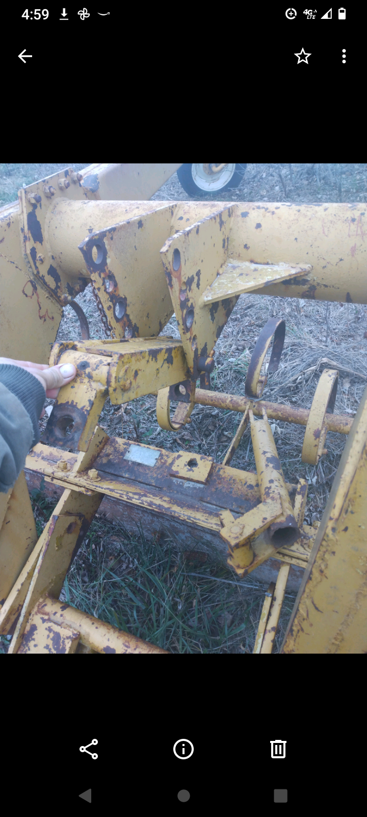

Hard to see in the pictures but there is a piece that pivots that bolts to the same bracket one would think the top link fastens to. However, there is a hole on the blade itself that I think is supposed to lift and pivot as the top link pivots as you drive so the blade is able to float or dig as needed. There is also a piece that is loose and appears to have been broke and rewelded sometime. I can't find any manuals or pictures of one online. Thanks again

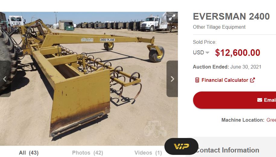

Thank you for the links and suggestions but I'm not finding one anywhere exactly like mine is. There was a style that has a front and rear set of wheels like the one linked above, then the TM (tractor mounted) like mine, then the 1200,1400,1600,2400 series that are similar but have a hydraulic leveling system. I'm thinking of trying to build something like the more modern ones using the framework I have, but was hoping I could find a reference or picture somewhere. Thank you all again

Adam, yours does look like an older version of the 2400 .... and also a competeter was the Holcomb... couple photos may give you ideas for a 3 point lift.... more photos on the  web site..
https://www.tractorhouse.com/listing/auction-results/205360761/eversman-2400-other-tillage-equipment
