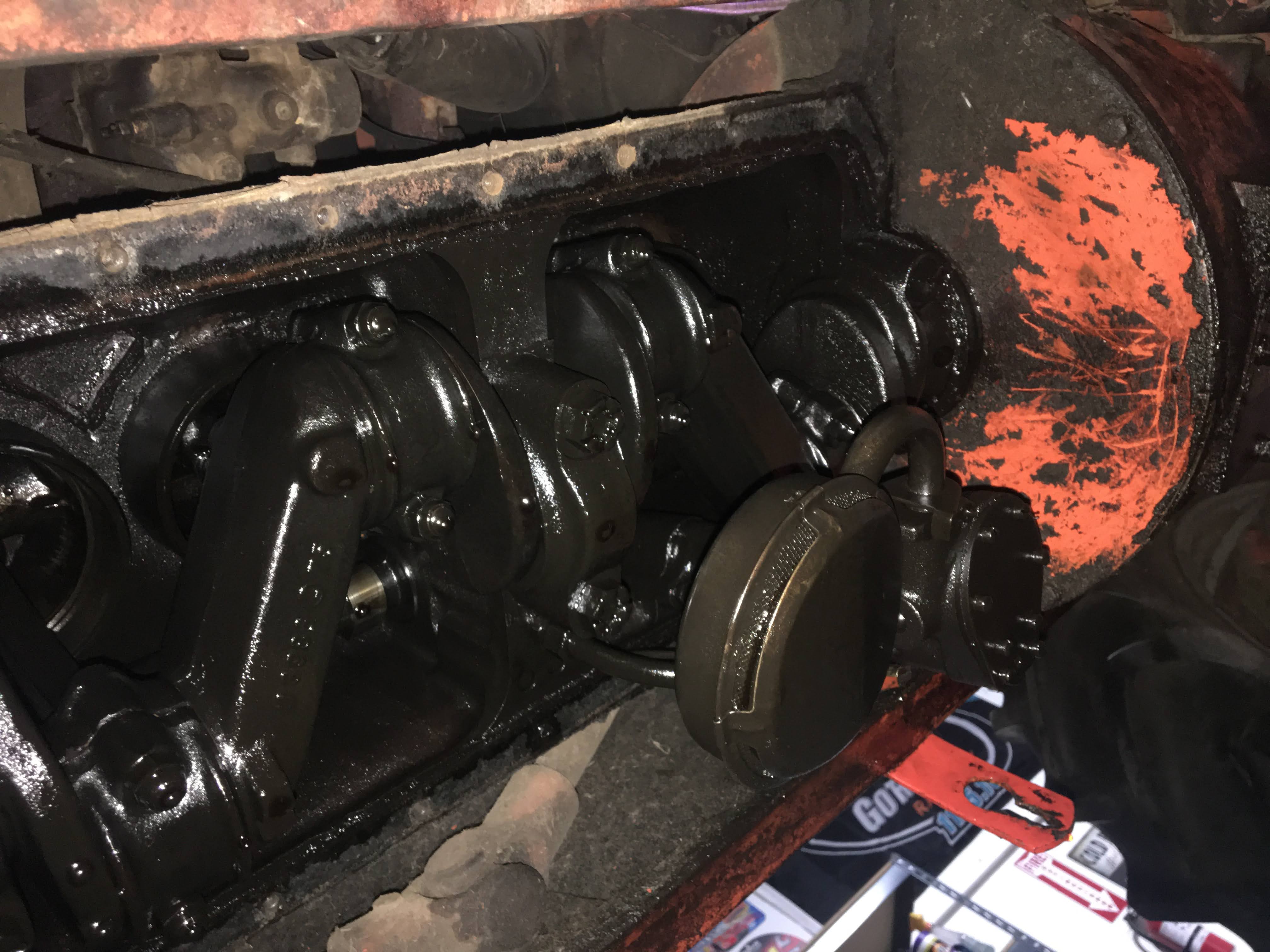

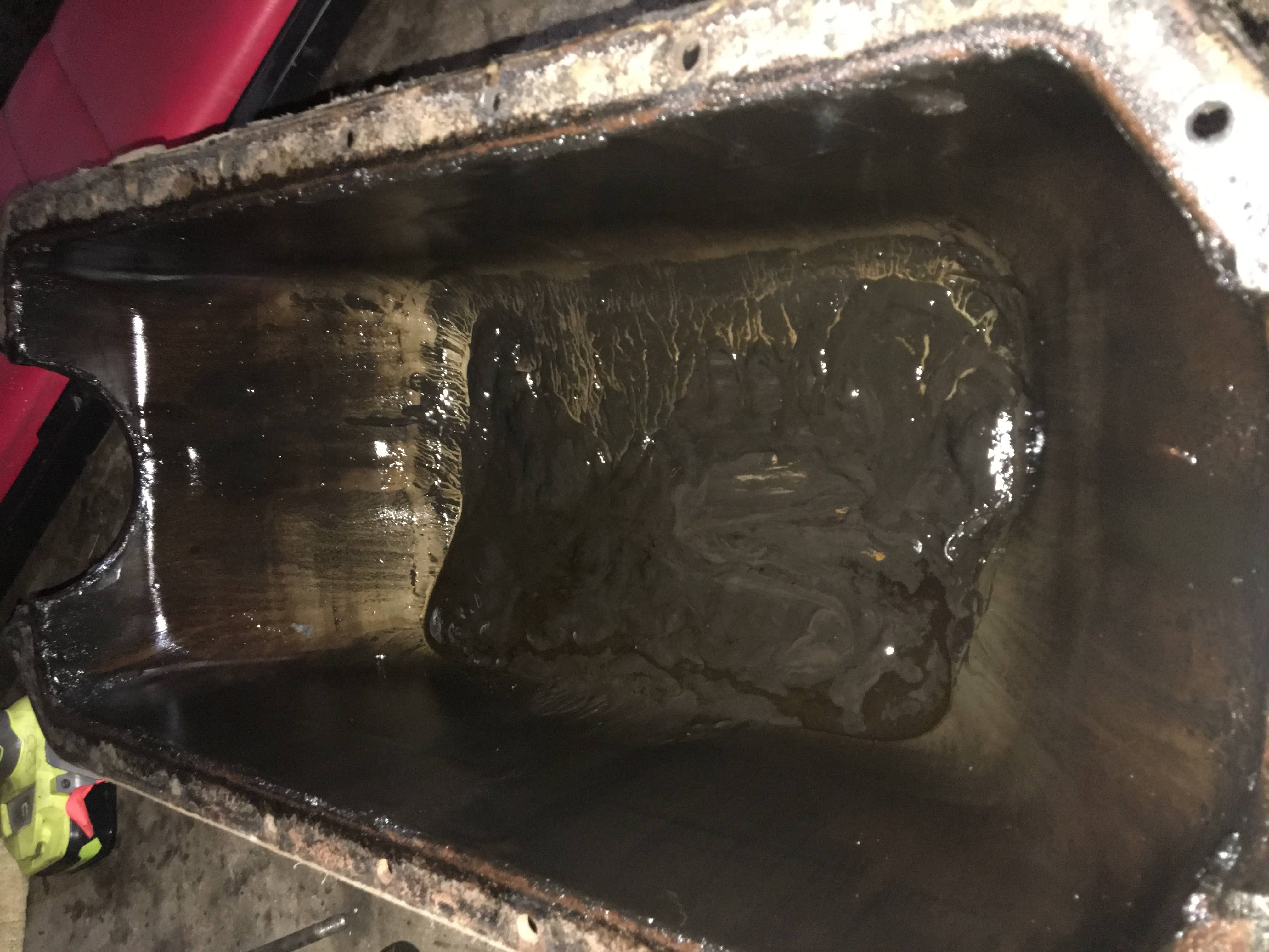

I just dropped the oil pan on my WD to find a couple cups of sludge built up in the bottom of it. After getting it from my father-in-law he swears it has only ran non-detergent oil in it which would make sense after seeing it. The engine block itself is surprisingly clean with only minor carbon build up. I plan on taking off the valve cover and cleaning that as well. I'm wondering if I should be concerned at all with the screen on the bottom of the oil pickup. That had to be sitting in all that sludge and couldn't be good for it. I'm not even sure if that screen comes off, or if you have to replace the whole pump? Also, after I get all the sludge cleaned up, thoughts on switching to a conventional motor oil? Up here in Minnesota I'd like to be able to run a 10w30. Thanks!

That is why you use a modern oil in these units. I use 5w40 in my WD45 all year round. Great starts in winter and it is cold up here in Canada. I'm near Barrie, Ont so lots of cold weather. Use whatever you prefer 10-30 or even 15-40. 15-40 may be a bit harder to start in winter. I'm sure the firestorm will start as everyone has different opinion. LOL.

Been told for years that if it has a filter use conventional motor oil. Non-detergent is meant for engines with no filter.  I dont remember if there is a cotter pin or bolt that holds the screen and tube to the pump. Would have to remove the screen and tube as an assemble and flush by pouring solvent, gas, mineral spirits down the tube.

I agree, take the  screen/tube ass'y. off to clean.
I would place in a pan big enuff to hold the whole thing
and let it soak for awhile.....then blow out with compressed air.

I highly recommend a can of Seafoam in he crank case after you put the pan back on. It will clean all the carbon and sludge up. Just follow the instructions on the can. An amazing product that will clean the inside of the engine and anywhere oil goes. Rings,valves etc...
Just dont be shocked how black your oil will be in a half hour of run time. That just means its cleaning that nasty junk out of your engine. If its really bad you may have to do it twice.

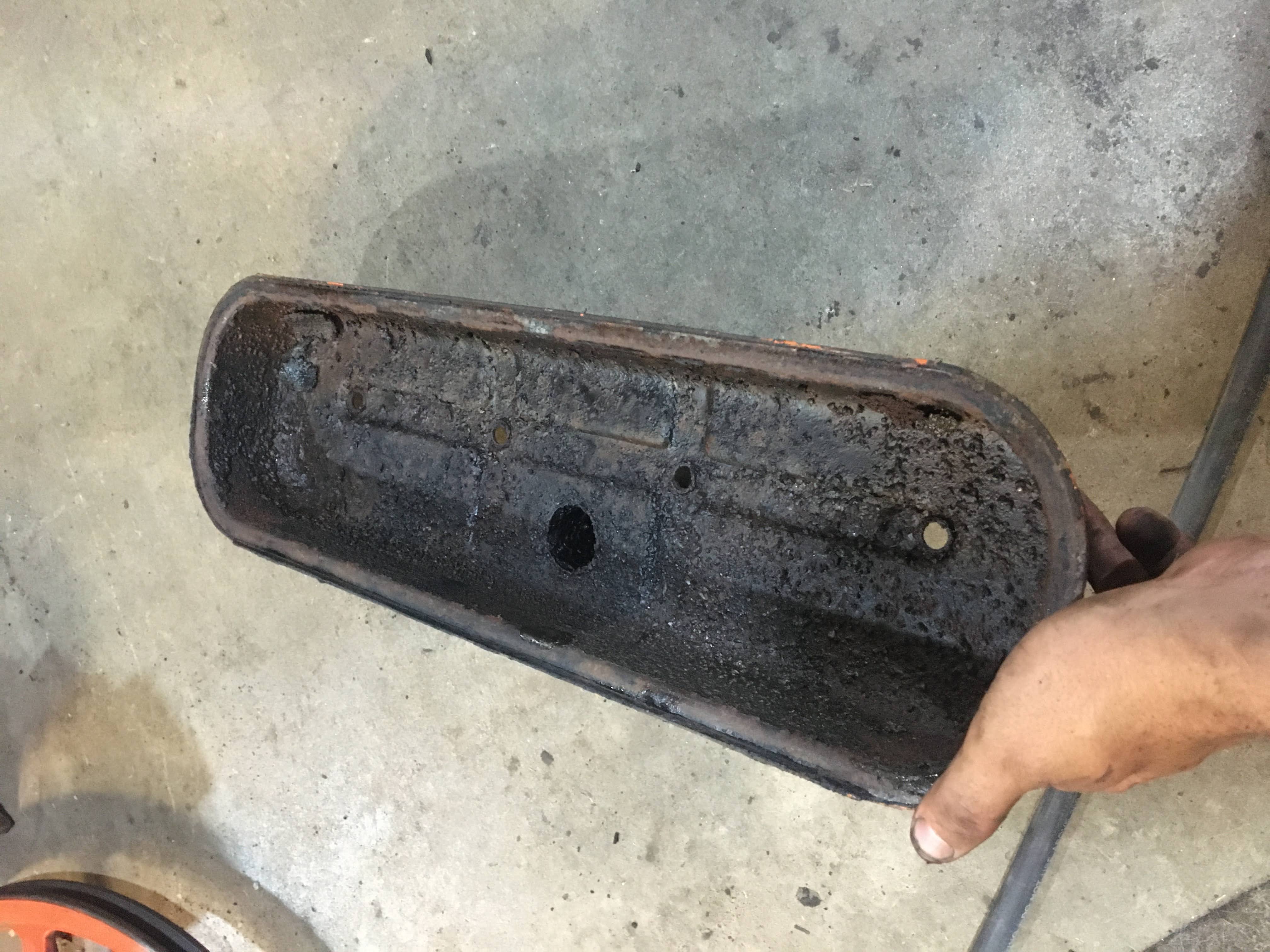

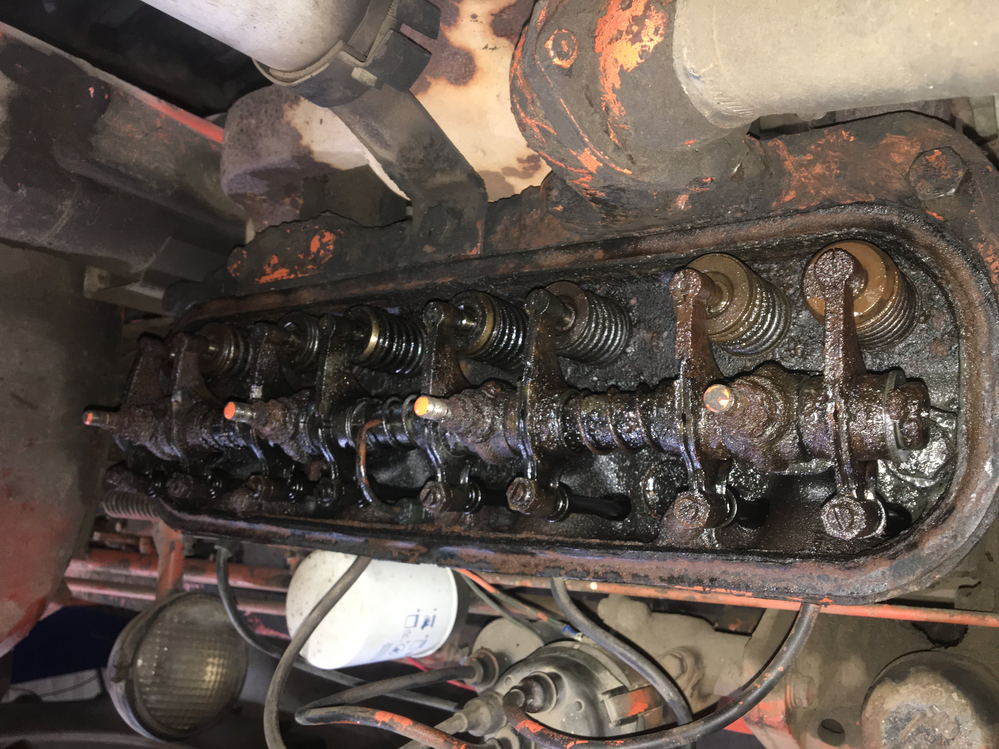

I took the valve cover off this afternoon and found quite a bit of buildup on the valves. I've vacuumed up as much as I can. Taking a pick with the vacuum right by it, I felt like a dentist! Would any of you have any concern running conventional oil nowadays after getting this all cleaned out? Hopefully nothing else would get dislodged and plug anything up. I'm going to look into running that seafoam through for a little bit and try to get whatever I might have missed.

I would run conventional, but change the oil and filter sooner the first couple of times. Running the sea foam will speed up the process. With the sea foam you have to change oil sooner because of the crap it loosens up.

I just dropped the pan off a WD last week. The sludge was so thick it had sucked the oil pump screen up around the bolts and it was puckered in every way it could. You can remove that screen and if carful get it back in shape. - wire around in a groove - if carful you can reuse the wire or can also make another one.

Pull the push rod cover plate on the opposite side of the carburetor and clean that area of also.

remember the B-C motor is an oil FILTER BYPASS system.. You dont loose oil pressure if it plugs up.. You actually GAIN oil pressure and flow.. Monitor the oil color and FLOATING CRUD  on the dip stick after installing new oil.. After several hours of use, you can drain the oil if it looks BLACK and has CRUD... You will know more AFTER draining it.. You can strain it and reinstall, or best to just put in new.. Just get the cheapest 10w 30 oil the have at Wal Mart for the FLUSH...... Changing the oil filter might be a good idea after a while. I might not change it the FIRST FLUSH as it will continue to pickup CRUD and will NOT REDUCE OIL FLOW to the bearings.
