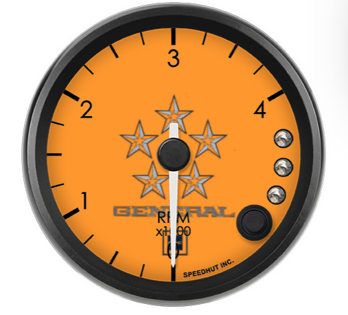

8070nc, I looked at Speed Hut and Autometer.  Since you say Speedhut had everything you needed to do a Gleaner L3 engine, I thought I would see if you could provide which Diesel Tach model you bought and what method of input did you use for Tach?    SpeedHut mentions that there are 3 ways to use their Diesel tachs: an alternator with an ‘R’ or ‘W’ terminal, a crank sensor signal, or a magnetic pulse sensor.  I think Leece Neville calls the R/W terminal "AC Tap".  I got to clean my alternator off to see if I can find it.  Did you have any trouble calibrating it?
The configurable color and logo is definitely cool!  It is about the same price as other Tachs.  I have been thinking about some orange lighting on the outside of the truck so an orange tach would be a way to bring the Allis theme in play. :-)
I love the design tool they have online.  This is my first stab at the design.  Hard to find a clean gmc general logo so far.  I need to move the general on top of the stars.

That is swweeeet! I had a feeling that was your logo. I am wondering about those shift lights and how they will work. I also noticed I can get a GPS speedometer from them with the same features. Of course, the two gauges are going to set me back about $550 but can do it myself. My son would love all the gauges to be speed hut. Thanks for turning me onto that company!
