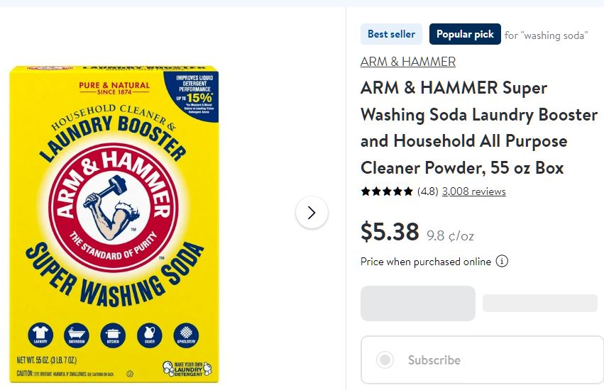

I have not done it for over 10 years.. But i was buying the "washing soda" in the laundry section of Wal Mart.. About 3.5 pound box.. I would add that to a plastic 55 gallon drum that had about 40 gallons of water in it...... The PROCESS depends on how many AMPS you can put out.. If your using a small battery charger with 4-5 amps, it dont work near as good as a 15 - 20 amp charger..... adding a little  EXTRA soda can make the amps go up and work somewhat faster.

I used plastic 45g drum, handful of washing soda(not much needed...), and LOTS of 'collector' steel around the entire inside of the barrel.
More amps = more aggressive the action so done faster. The close the two 'electrodes' are (piece and plates) , = more amps as well. 1/2ve the distance ,get 4x the amps.

It's better to use washing soda, LYE is really, really BAD on YOUR skin !!!!
