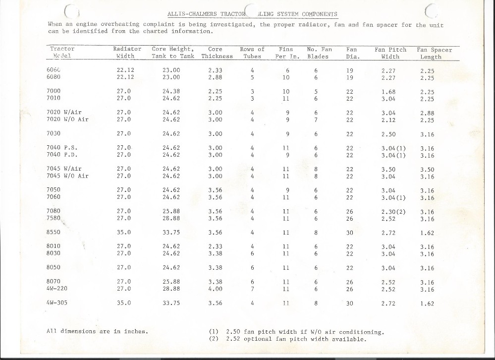

How about the radiators in the 7045, 7060, and the 7080? Are any of them the same size or when they step up the horsepower, did they step up the radiators as well? I have an inter-cooler on my 7045. It came off of an N6.
Points: 22814
Post Options Post Options   Thanks (0) Thanks(0)   Quote DrAllis Quote  Post ReplyReply Direct Link To This Post Posted: 09 Jul 2020 at 7:03am
Radiators are different on all three. More HP needs a higher capacity radiator. Intercoolers on 7045's can cause heating issues on HOT days at high HP output.

Interesting that it shows the 7045 being the only 2wd to have an 8 blade fan. Didn’t know 8 blades were ever a thing on the 7000 series.
Points: 22814
Post Options Post Options   Thanks (0) Thanks(0)   Quote DrAllis Quote  Post ReplyReply Direct Link To This Post Posted: 10 Jul 2020 at 9:06am
That's because the radiator was really too small for 145 HP, so they tried more air instead, which draws more trash and harder to keep the radiator clean.
