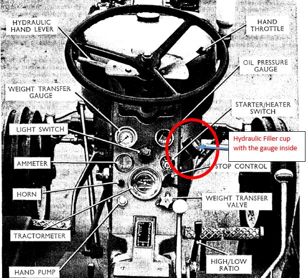

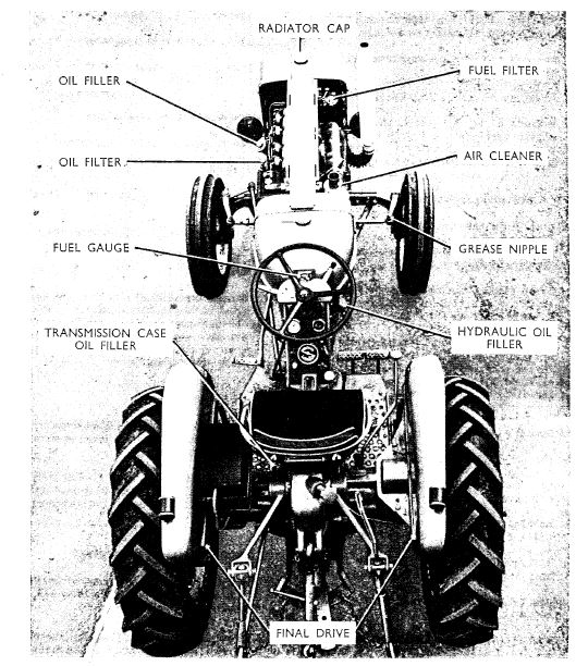

Have a look on the pictures attached.
Filler is in the right side panel under gas tank

Thanks mine don't have a filler there

We had 3 ed40's the hydraulic oil and transmission oil same reservoir. There is a dipstick down at the rear of the floor board. It  may be on the left side instead of the right. It has been several years since we had one. Our lift levers were on the right side next to the fender, not on the steering column like the picture shown in previous post.
