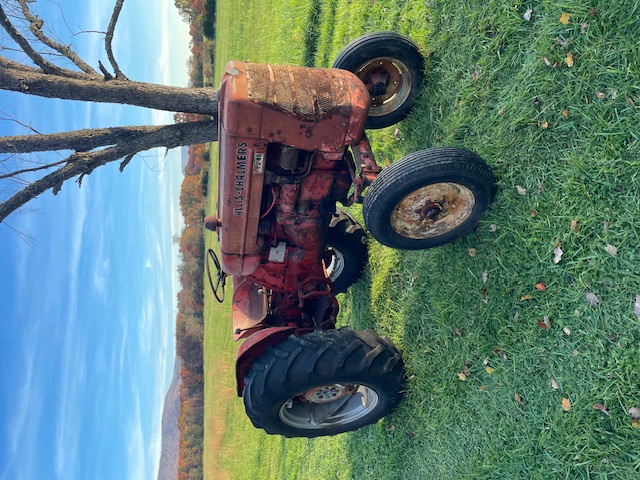

Greetings from the Shenandoah Valley of Virginia. I am new to the forum and wanted to post my most recent purchase to share. An ED 40 that spent most of it's life at the Homestead Resort pulling a finish mower. It runs and seems like a solid candidate for a resto.I hope to learn all I can from you folks about this model farm tractor. I've included a picture.....

Welcome. It's nice to find a complete running ED40 Those have some unique problems that some that have them can help you with.

Yeah, IIRR, the most common major problem is that something in the lift breaks a casting...

Thanks for the heads up on the casting issue. Right now, I need to replace a steel hydraulic line before I can start it.
It is missing all the 3 pt. hitch equipment. I hope that's not a bad sign of things to come. No draw bar either.
The exhaust is also missing. Just the down pipe from the manifold.
I don't have big plans for the tractor. Maybe pull a mower once in a while. Parades and Steam and Gas shows. Something to tinker with in retirement.
