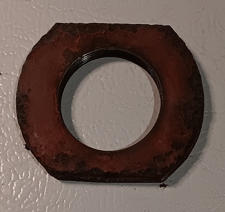

Post Options Post Options   Thanks (1) Thanks(1)   Quote PaulB Quote  Post ReplyReply Direct Link To This Post Posted: 24 Dec 2024 at 6:43am
OEM B axle nut

Post Options Post Options   Thanks (0) Thanks(0)   Quote ekjdm14 Quote  Post ReplyReply Direct Link To This Post Posted: 25 Dec 2024 at 10:32am
OEM B axle nut
That's the beastie right there sir. All I can think is they wanted a larger surface area for torque application than a 6 point would have provided. I'm sure a Fein 1" 110v impact will get me close enough though as long as the socket holds up to the abuse!
