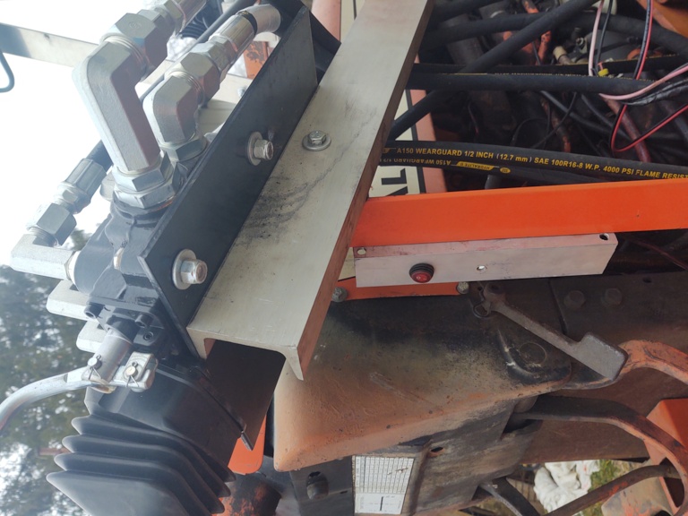

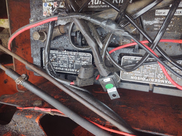

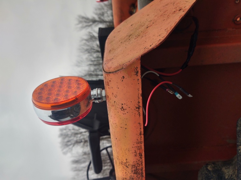

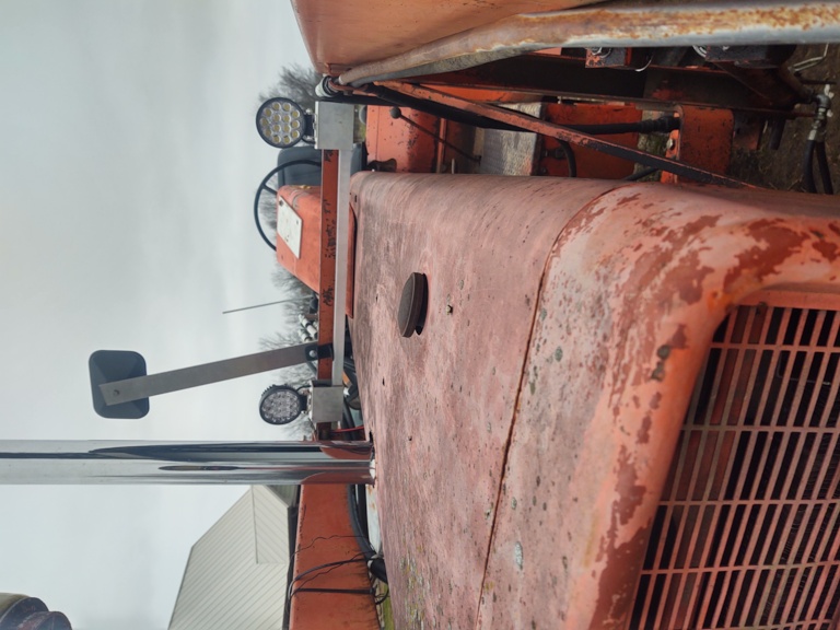

What else do you suggest?  See pictures below.
New LED front loader light switch.  The other red/black wires hanging are for power to a baler moisture tester that come off of the key switch.
New LED flasher/turn signals (not wired yet)
Wiring harness, fuse and relay yet to be permanently mounted.
Front loader lights.  I had some scrap aluminum so rigged up a mounting system for LEDs.  The aluminum plate on the dash cowl is for the baler moisture tester display.
